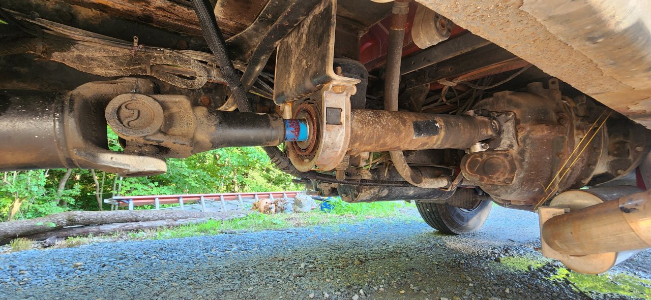

    Thanks guys. When I did the front U-joint and took off the front shaft, I marked the splines and put it back how it was. It appears to be in phase. Does it matter if the U-joint cap part of the Yokes are in the same spot front and rear? I attached pics.
    I also jacked it up again and took a video of the driveshaft spinning. Slight wobble it looks like? 20250619_193440.jpg 20250619_193450.jpg Hopefully video uploads.

    I'd say worn splines on the driveshaft(s). The fact it is more pronounced with a load, is the rear suspension is collapsed more and rides on the worn part of the splines.(?) A bad harmonic balancer will cause vibrations under load. Typically, a worn U joint will cause vibration under load too, I'd replace those as well, and with GOOD ones, not that Chinese junk. Caution, you can spend a fortune on "vibrations" and if you aren't going very far, I'd just put up with it. Lords knows, we all did. Not to preach, but 55-60 with an excavator is too fast anyways,,:biggrin_25516: Good luck.

    Might be a stretch but have you compared driveline angles empty and loaded?
