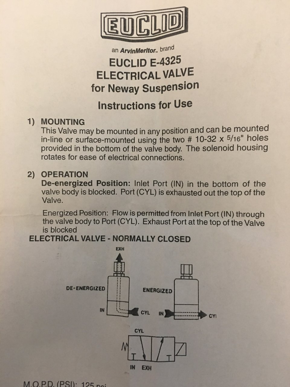

    Parts house sold me euclid E-4325 to use for rear axle dump valve. Its normally closed and opens to exhaust when power is killed so it stays hots unless being dumped.

    I would return that.

    I would want it normally open, if a wire would break or otherwise lose power you don’t want the axle dumping.

    You want a valve that when you put the power to it that it opens to dump the air not one that you have to keep power to all the time.Too many things to go wrong with the one you have.
