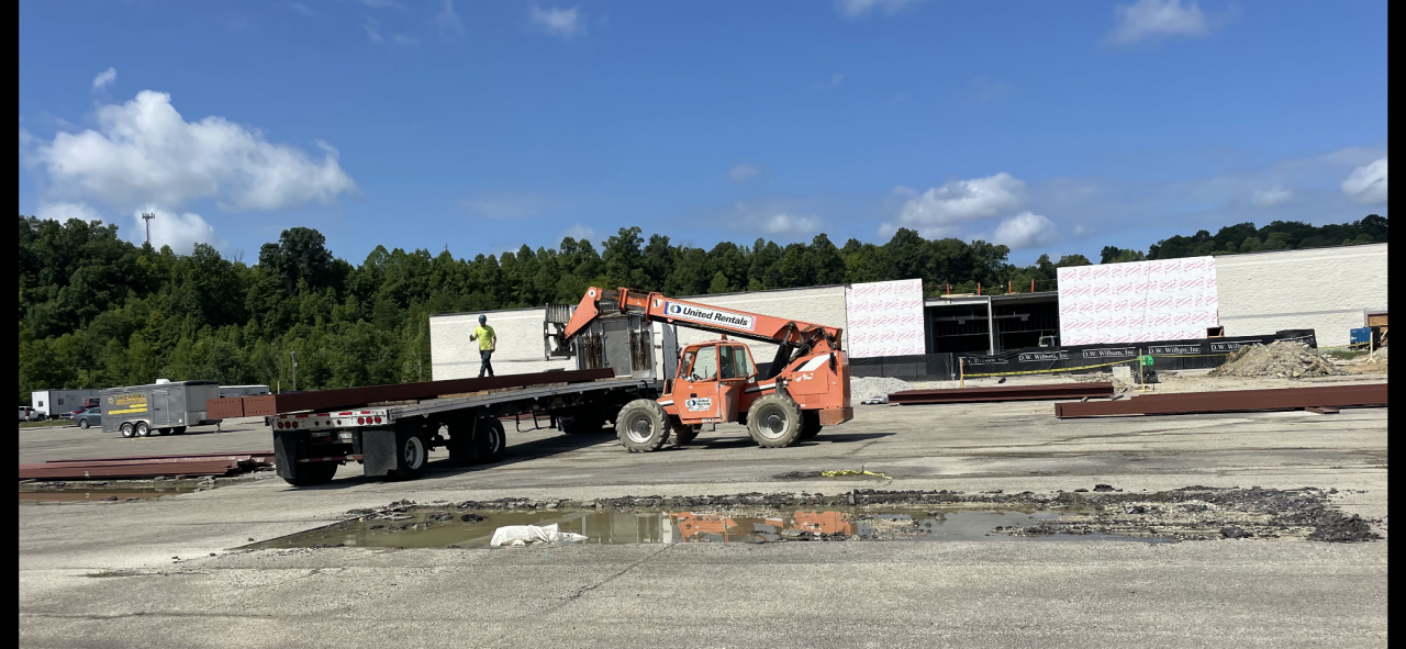

  10. OLDSKOOLERnWV
    19,218
    290,751
    Dunnage like this….?
    They loaded me with a crane and used chokers to pick the beams, dunnage between the layers of beams is necessary to remove the lifting straps / chokers. Also necessary when you will be unloaded with a forklift or telehandler….
