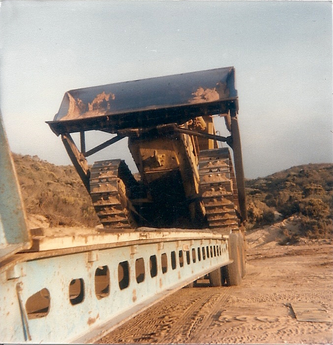

    #32
    Check the fuel level of the machine you are about to load. Running out of fuel in this position is not good.
