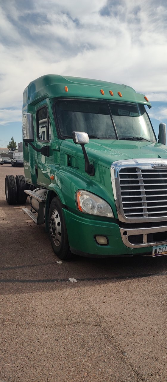

    I have a 2010 freightliner cascadia with a dd13 and a eaton autoshift (no clutch pedal has a paddle shifter on the column) i had a clutch put in it about a month ago worked fine for three weeks now it wont go into gear have replaced the clutch brake and repaired a air leak at one of the solenoids the xy shifter is about 2 years old i have had 4 different mechanics hook the computer to it 2 with the eaton software yet nobobdy can figure this out eaton shop wanted 6500 to take the clutch out and reinstall it not sure what that would do but seemed excessive just curoius if anybody had any ideas???? Thank you in advance
