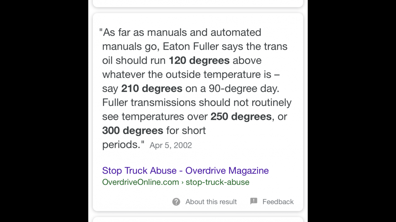

    250 is too hot. You are breaking down the oil itself. Then induce a spiral upwards that never stops.
    Put a air cooler on there.
    190 or so upgrade isnt bad, that bad yet. But when you get above 200 towards a max of around 225 Im looking for a spot to give her a rest soon if it's hot outside.

    230 uphill is not too bad. It's working hard.
    I hope you got a air cooler for that trans oil, pay mind to the engine oil temp, your axles temp as well as the pyro if you have those gauges. If all are similar such as 215 or so to 230ish on the axles and about that much agreement across the board with the coolant where it should be you are doing fine.
    But keep an eye on it. Take a downshift and ease off the hammer a little while take a load off. It might take you another 20 minutes to get up and over. Give her a little slower coming down to cool off that work you are doing.
    If the trans continue to climb past 250 that's quite enough, you need to find a shop and quick. Especially if your axles and engine do not also agree with similar numbers going up along with it.
