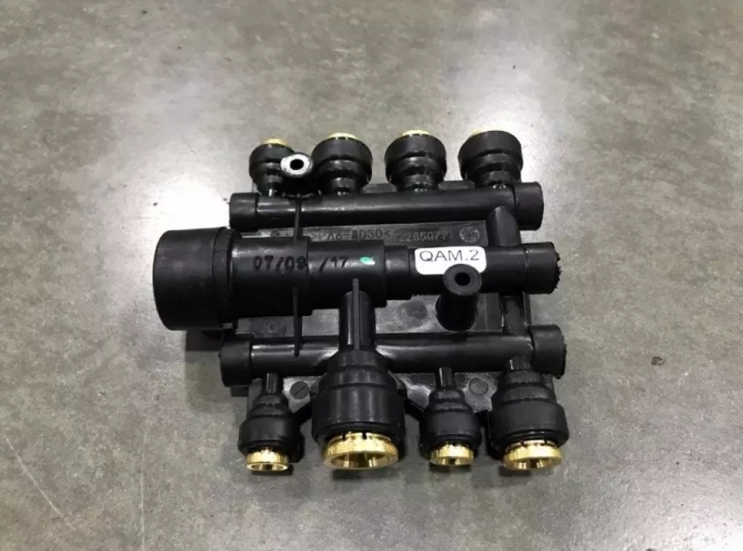

    Has anyone dealt with these codes? This is a follow up to an earlier post when i stated my Transmission is stuck in low gear and my air bags won’t inflate. All after of this occurred after my batteries removed and air tanks installed.
    Mid 130 sid 56 fmi 7
    Mid 140 pid 76 fmi 6
    Mid 140 pid 177 fmi 4
    Mid140 pid 116 fmi 6
    Mid 128 pid 27 fmi 4

    Why did you have the air tanks replaced?
    Have you replaced the saftey manifold? That supplies air to all the accessories. Ie airhorn rear airbags 5th wheel and transmission.
    Its located on the inside frame rail under the drivers seat. Roughly

    No i didn’t check or replace that. My air tanks were leaking

    But do you have air going into all the air tanks now? 120lbs or a little bit more?
