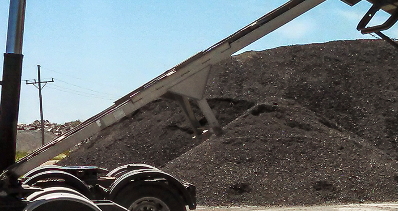

    Frameless dumps often don't have the landing gear that many other types of trailers have. NO way they can handle the load on them. Would fold instantly. Therefore....assisted dumping is necessary.
    As for the OP, yes I've had that happen a couple times in 11 years. And once, and ONLY once, thank goodness...I've had a hydraulic hose blow about 1/2 way up and still loaded with ag lime. Came down hard. And fast. Scared the crap outta me. And COVERED the truck and some of the interior (since the windows were down) with hydraulic fluid.

    i dumped another trucks side dump trailer like that before.

    Plus, most dump sites are not on concrete, so even if the trailer legs could support the weight of the load, the ground underneath probably could the ground underneath probably couldn't.

    the time i did it was the last load of the day construction guys were in a hurry to get us out of there and get to the bar. the guy could not get his pto to in gauge with them breathing down out neaks to get out of there i pulled up beside him and unloaded his trailer just like in the pic. and we left figured out the problem that evening at the truck stop.

    There is never any reason good enough to ever justify dumping this way. Period. Let it down, go somewhere, fix it. Even if it means dumping the next day or Monday. Trailers with drop legs can be dropped if done carefully but it is highly recommended to not do it.

    Not to argue with you, but...if I've got a load on that's gonna freeze up on me over night or over the weekend, I'm gonna do anything and everything (safely) to get that load off. Not a CHANCE I'm gonna shovel out 22 or more tons.
