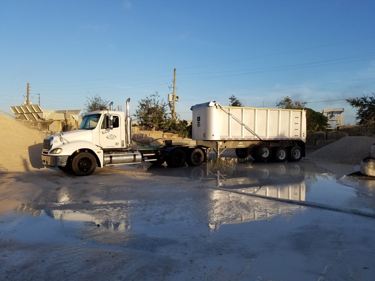

    Currently pull this. Florida spec 30ft tri-axle. 80k legal on interstate, 88k on regular roads. Require 43ft and 6 axles for those weights. 51ft and I could lose one axle. At 44.5ft with this one.
    Hate the way the current one loads so I bought this a few weeks ago. 30ft frameless. Currently in shop to bring up to DOT requirements. I'll lose about 1500 lbs payload but for the cost to own this vs renting the above one I'll end up better in the long run right now.
