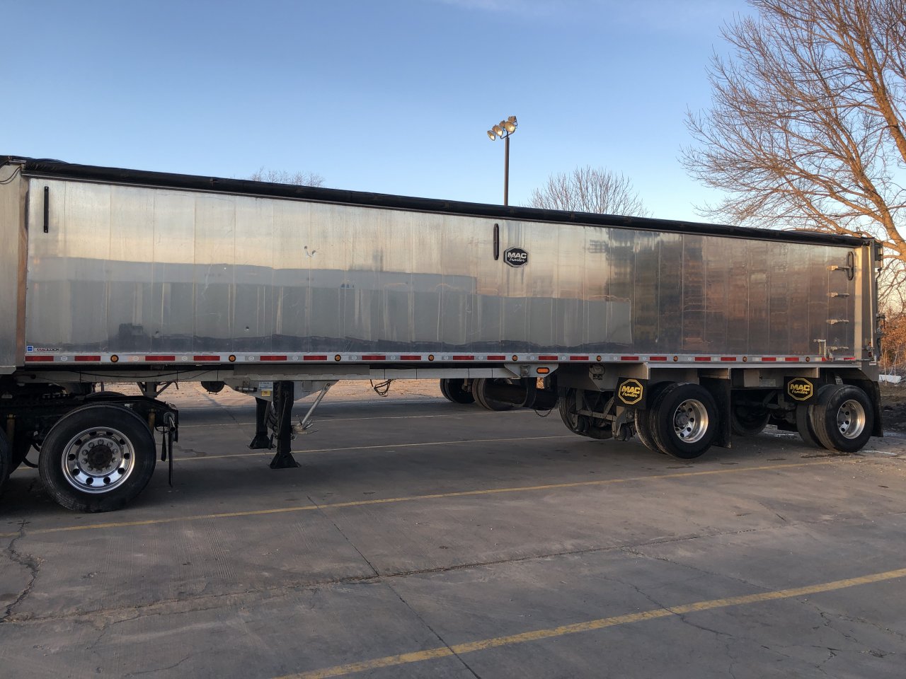

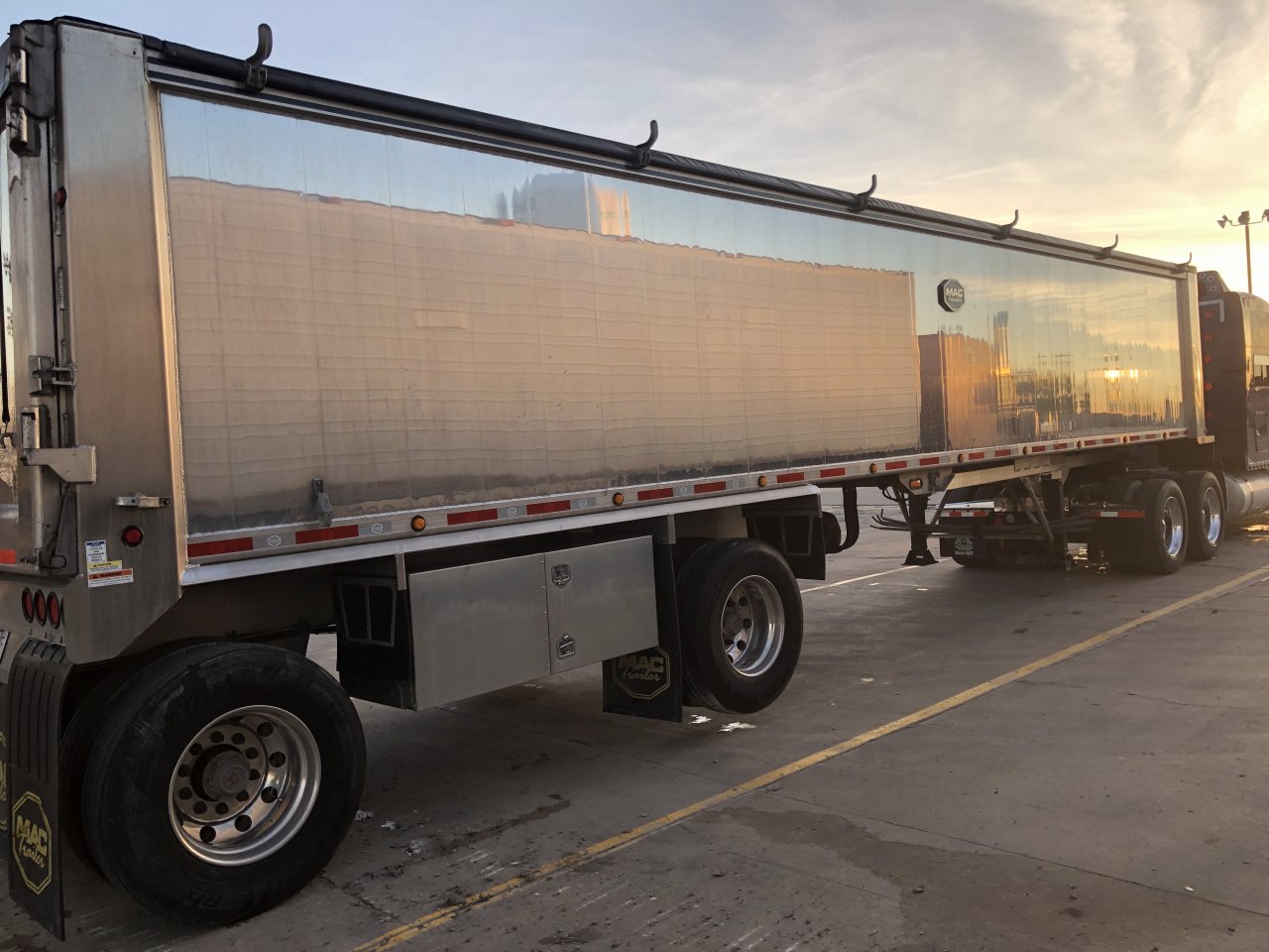

    However if you do go dump I have a 17 for sale A4F3DA6F-2B2B-40C5-9956-E0CAAC02100C.jpeg 7886B9A6-15E5-434D-BCF0-0E5247A81526.jpeg

    Ok yes if I do go dump I’m going half round frameless mac ..: I heard they make a anti tipping device for dump trailers ???
