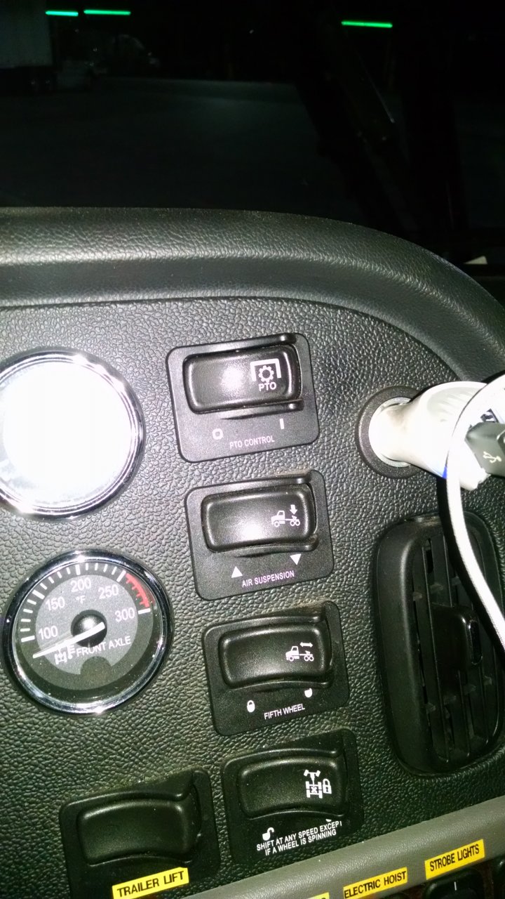

    Can someone tell me the steps to engage PTO in an automatic Freightliner?

    In a Pete with an Eaton auto (car carrier) while it's in drive turn the PTO on and then put it in neutral. Not sure if yours is the same but that's how mine worked.

    In an auto Peterbilt they installed a switch next to the passenger seat that you just slide from off to on. And bump the cruise up

    Mine was on the dash. I guess every application could be different.

    Some of our trucks have them on the dash. Our two autos have the switch on the floor. The autos had the pto put on at a later date

    yes thanks. I should have been more clear. I was asking about transmission settings in regards to PTO . Move trans from Neutral to Drive, PTO switch On, Trans to Drive.

    In addition. Park brake should be locked out so that vehicle will not move with PTO engaged. PTO operates in N. Drive just stops the trans from moving to prevent gear clash during engagement.
