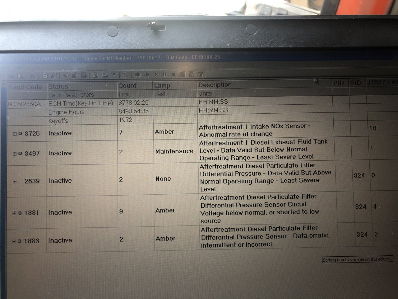

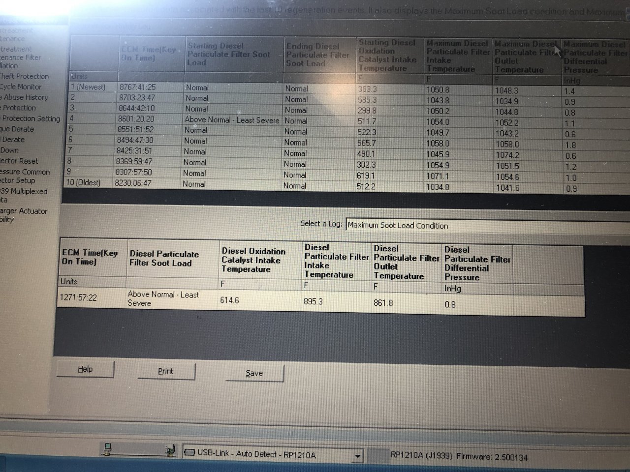

    This is what codes came up, and a log of parameters, anybody familiar with these?

    Replace (1) intake nox sensor (2) DPF differential pressure sensor (3) stop running your DEF tank so low.

    Replaced the sensor, checked the dpf pipes for soot accumulation which was none. Ran the truck today with a few loads and same derate message just came on and now CEL illuminated. This is killing me.
