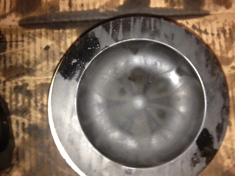

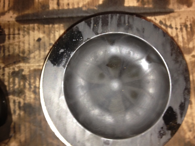

    IMG_5411.jpg Here you go, Truck always warms up 15-20 minutes. also has turbo timer to idle down. If the charge air cool or turbos were the problem would I be able to build full boost (58 lbs) Thanks again Trevor

    You need to look at the underside of the pistons to see if they are black and blue. If so then you either have one of three problems
    lack of oil from the cooling jets
    too much fuel
    not enough air

    I guess from reading the above it was all 6 Pistons so the chances of all 6 Piston squirter's blocking is out of the list of reasons.
    Again it couldn't be all six with bad Injector Tips failing at one time.
    However the Head is Cracked in 3 places you mentioned!!! Usually seen after High engine temps.
    The piston crowns look to be well patterned and clean with no sign of bad nozzles.
    Did u do an Oil sample? I would be looking for Fuel Dilution and Oxidisation and then have another think about Why it failed.
    Smacks of Heat!!
    What about the Big end & Main Bearings? This may tell us if the heat was localised around the liners or in the oil as well.

    Are they aftermarket pistons or cat pistons? In my experience such a thing is not possible with genuine Caterpillar pistons
    The acert piston can take a lot of abuse and still not look like that.it is very unusual.
    I have had very similar failure with aftermarket IPD pistons

    HI guys thanks for the replies , They were aftermarket pistons and liners. I didn't see but I was told that the pistons are not discolored (black and blue) , Also told rod and main bearings looked fine. no oil sample was taken and I think it may be to late for that the motor is all torn down. Thanks again Trevor
