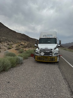

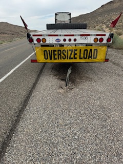

    In Nevada on the 318 going towards Ely last night. I pull over on the shoulder and felt a bump. Got out of my truck to see what happened and noticed fluid leaking.
    My oil pan was punctured by the metal reflector signs. After seeing that, my engine turned off. I did not attempt to turn the engine back on as the oil was leaking.

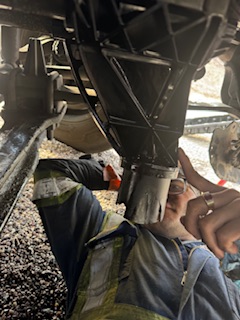

    Could my engine have been locked? Could some other wire or thing have something to do with this issue of metal stake on the shoulder? please see attached photos of metal stake, my oil pan and even the plastic part of the oil pump that was damaged.

    I am leased on and owe about 35k on the truck, trailer is paid off. Truck has 640k miles on it. Insurance has a $2500 deductible. I will be filing a claim through NDOT but not if I have to call the wrecker. That would take too long for me to get reimbursed and that’s if Ndot even approved my claim. The metal reflector was already bent to the ground and damaged as you can see I have no damage to my bumper. I am running out of cash to through at this situation.

    Those plastic oil pans don't hold up like the metal ones.
    Maybe you have a piece of post stuck in the teeth of flywheel.

    No way that engine locked up just idling and it shut down in protection mode. And I’ve never seen a 15 liter engine rolled over with a screwdriver. Get a breaker bar with a socket and roll it over on the crank dampener.
    Ive seen engines under load lose the oil pump (drive gear walks off shaft on N14 iykyk)
    And the engines fine.

    Came across a truck that ran on its side. The ECM download revealed the truck ran on its side with no oil pressure for over 30 seconds before engine protection shut it down. It wasn't seized.
    Also dealt with a zoom boom someone mistakingly forgot to put a plug in an oil galley when installing a new engine. It ran for over 10 minutes just on splash lube from the crank before seizing up.
    I bet your truck, if automatic, is jammed into gear. It can happen if the truck is shut off in gear with torque on the driveline.
