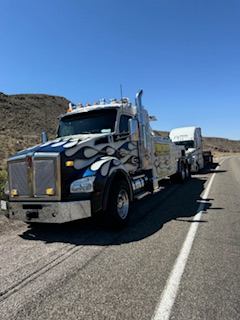

    I got towed to the Loves in Las Vegas. My company will send a truck with another truck so I can deliver my load and they can tow my truck to Chicago. I used a local Las Vegas Tow Truck Company. They were professional, efficient and had integrity
