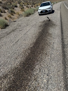

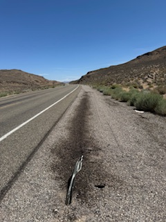

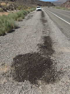

    Man brother you’re pretty cynical. The truck turned off within 2-3 minutes of me getting out of the truck. I did not turn the truck back on at all. This is where the oil spilled and no where else. Photos below

    Yeah maybe. That also doesn’t look like 11 gallons of oil. Was it already low on oil? Only reason I say that is a gallon of oil will look like the a major oil spill. But maybe I am missing the size and scope through a photo. And the desert drank it up.

    You are asking the wrong question, the right one is why did the oil slick (lack of a better word) only seem to be 60 feet?
    I had trucks which hit debris, and a couple put holes in the oil pan but they were 1/8 mile long with one that was two miles long. I know because I got the bill from the state of california for the clean up for the 1/8 mile long one and that one didn't lose all the oil but it was one big hole.

    Those arn’t hard packed asphalt shoulders. Those gravel shoulders will soak up a sumps worth of oil in no time.
    My guess is that sticker post punctured oil pan and in the process broke oil pump pickup and a piece of it or something may have been either sucked up or found a lodging place in the cranks rotation somewhere. Maybe there is a rare instants were because this was a quick catastrophic loss of oil the engine protection shut down thingy needs a manual reset to allow fir up again.
