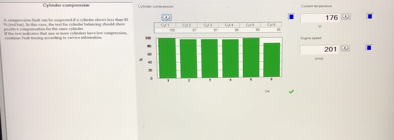

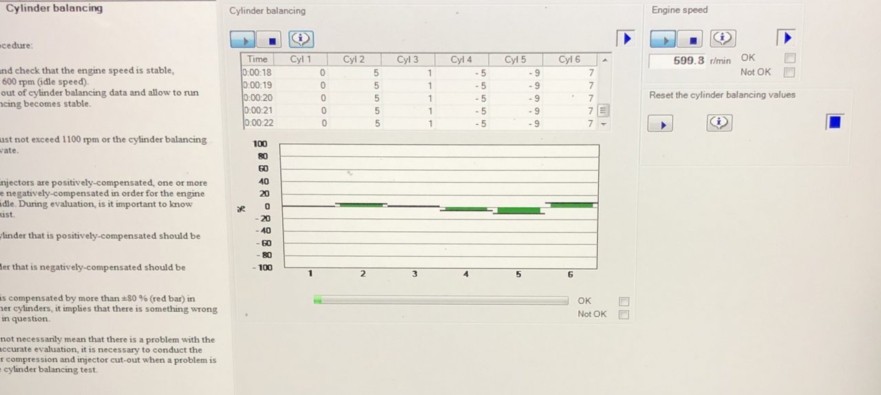

  11. Newto Trucking
    Newto Trucking Medium Load Member
    359
    226
    Dec 26, 2013
    NE Illinois
    Whoever gonna connect Volvo software to your truck next time make sure they do this 2 tests and do compression couple times one after another because on a second or third attempt some cylinders may drop significantly
