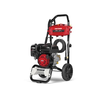

    The first thing I did when I bought my current truck was pressure wash the engine. It had oil smeared around the oil pan. Once I wash it good, I fired it up, kicked up the idle and found the culprit. Oil was coming from one place only, Front of the fuel pump(gasket). Seems it’s a common problem for these “Come Apart”(Cummins) engines when they reach certain mileage.

    That's nothing compared to a steam cleaner..
    That actually works..
