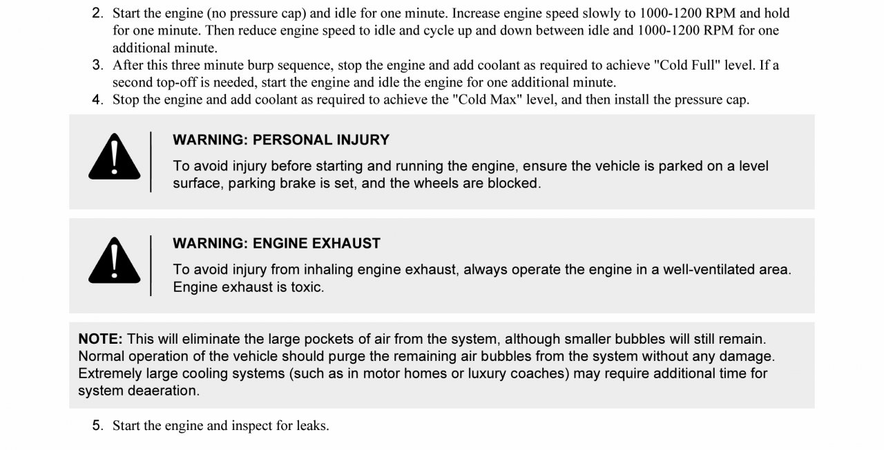

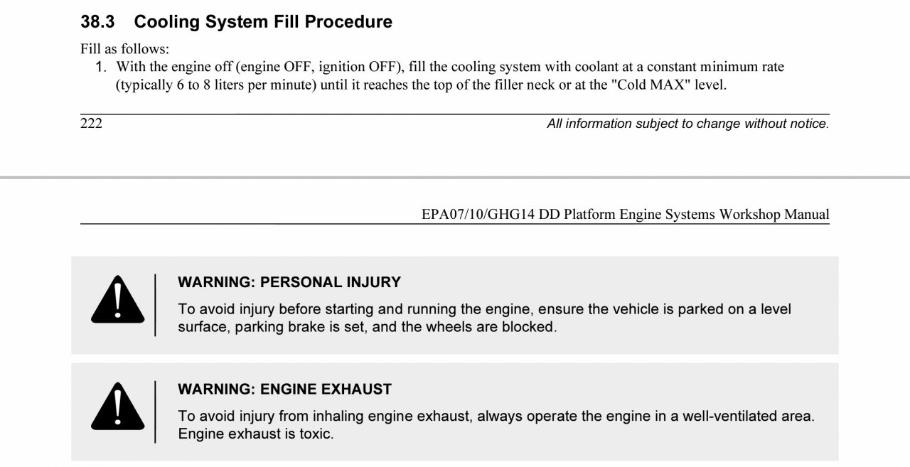

    Just for educational purposes, here are the full instructions on how to refill the coolant system based on a Detroit repair manual.
