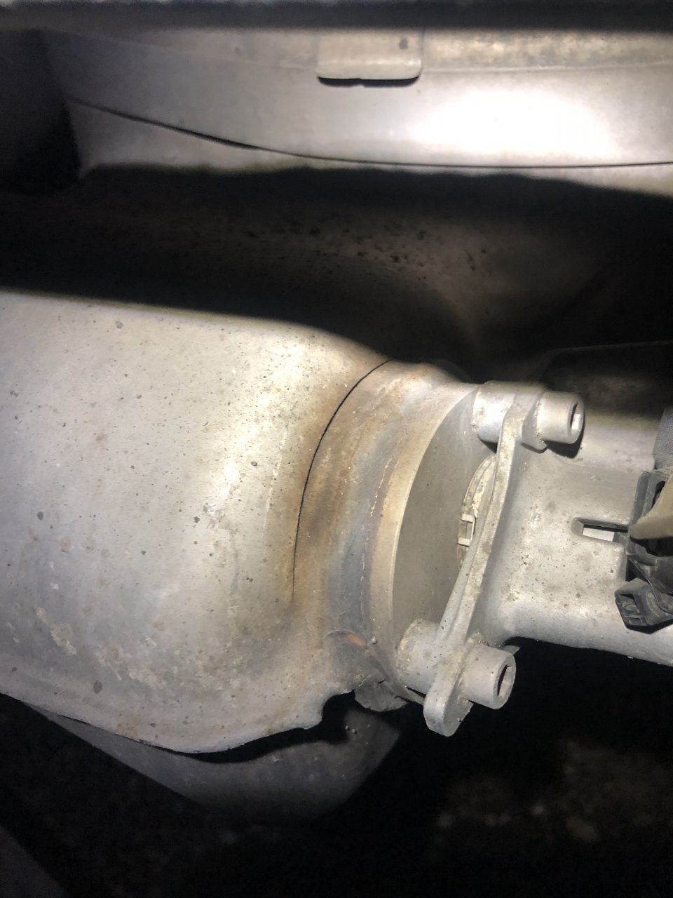

    What’s the mileage on a truck??

  4. Newto Trucking
    Newto Trucking Medium Load Member
    359
    225
    Dec 26, 2013
    NE Illinois
    The next time you do parked regen at the shop insist on a removing fairing on a passenger side and metal cover only 2 nuts on each side to get a better look above def doser for a crack, after 15 minutes it will expand pretty good if it’s there.

  5. Paul Chamberlin
    Paul Chamberlin Bobtail Member
    40
    20
    Aug 6, 2018
    Highway
    I’ll look b4 I go. Thx
