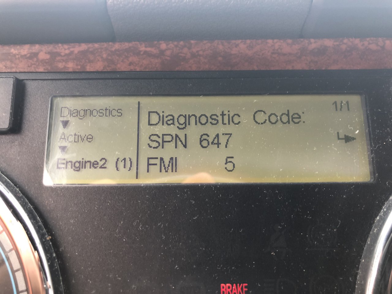

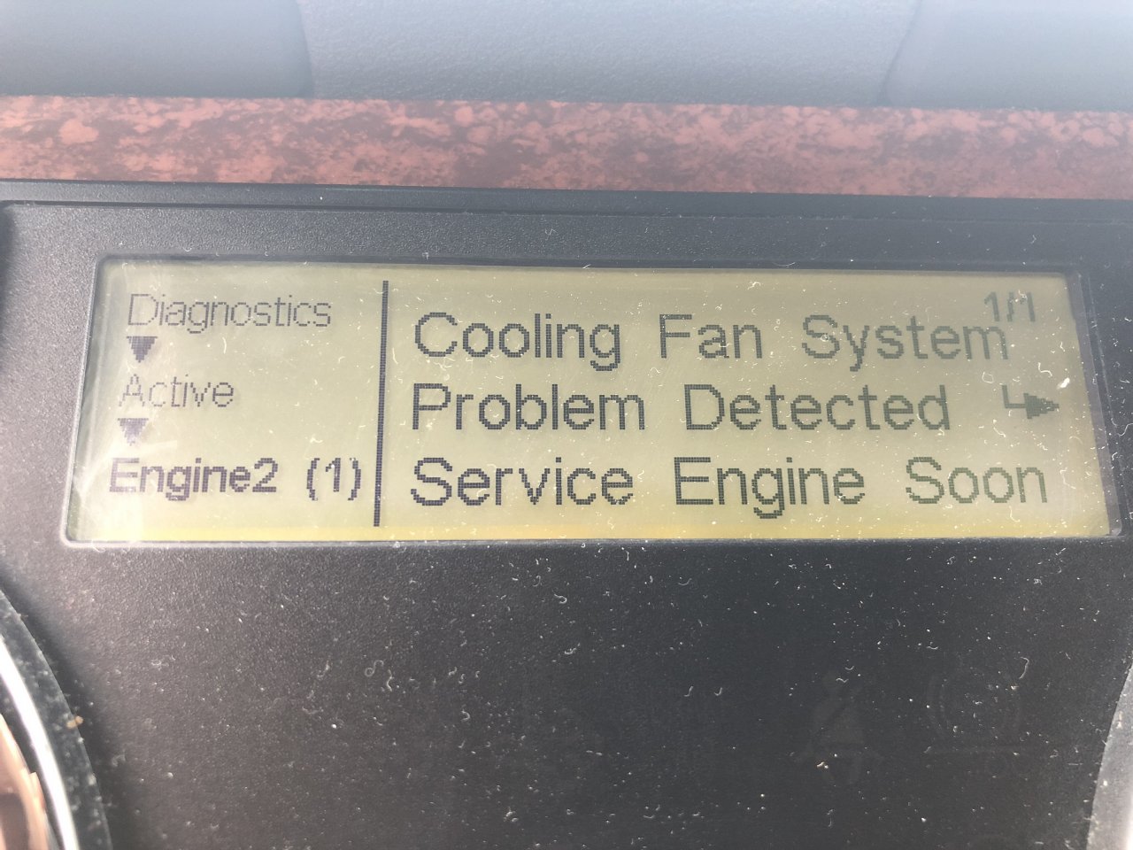

    Update. When I started engine today morning, the began to rotate fast first and then slower, so it changes modes. So I guess it works properly. But when I opened “diagnostics” on my dash, I’ve found that the problem still presents. See pic. Fault still active but fan works as usual.

    sometimes the computer has to do so many diagnostics checks before the code becomes inactive and disappears. I have had some do that on me. If the fan is changing speeds, then it should be back to normal. If it’s running full blast constantly a few days from now, check the resistance on the plug and harness and if it doesn’t meet the values, change the solenoid.
