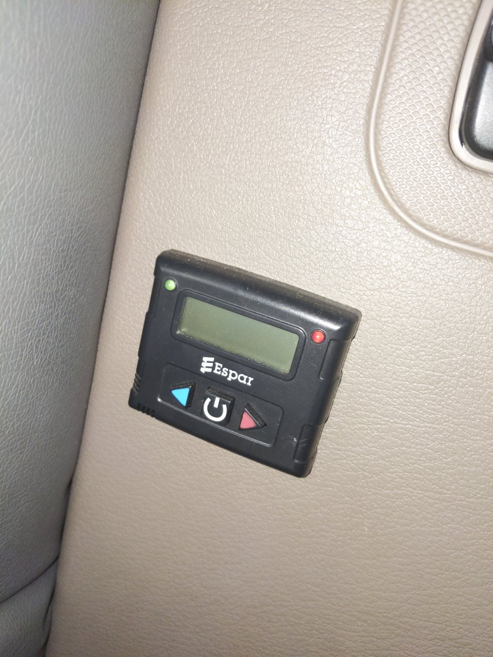

    Yes I checked every fuse possible n all are good
  3. Keepontrucking2016
    Keepontrucking2016 Light Load Member
    170
    40
    Apr 7, 2016
    Agm batteries are brand new pretty much
  4. Keepontrucking2016
    170
    40
    Apr 7, 2016
    I checked two wires one is red + the other is ground n have no power 15692126324175092570025965785410.jpg

    Dumb question
    Are you checking it with the truck running or key turned ON...?
    Opendeckin Thanks this.
  8. flood
    flood Road Train Member
    4,169
    4,051
    Dec 25, 2010
    it would still gave power and try to start
  9. flood
    4,169
    4,051
    Dec 25, 2010
    The reason I asked about the truck running or key turned ON is I have the same unit.
    For safety reasons the truck cuts all power to the bunk heater when you turn the truck the key on.. the heater only gets power when the key is turned off
    Midlife Trucker Thanks this.
  10. Keepontrucking2016
    170
    40
    Apr 7, 2016
    Off
  11. SteveScott
    SteveScott Road Train Member
    4,897
    16,809
    Nov 10, 2015
    On a truck I drove for a job a few years ago, the relay failed that turned the unit off when the ignition was turned on. I started the truck and noticed that the heater was still running. Maybe your unit thinks that the truck is on.
