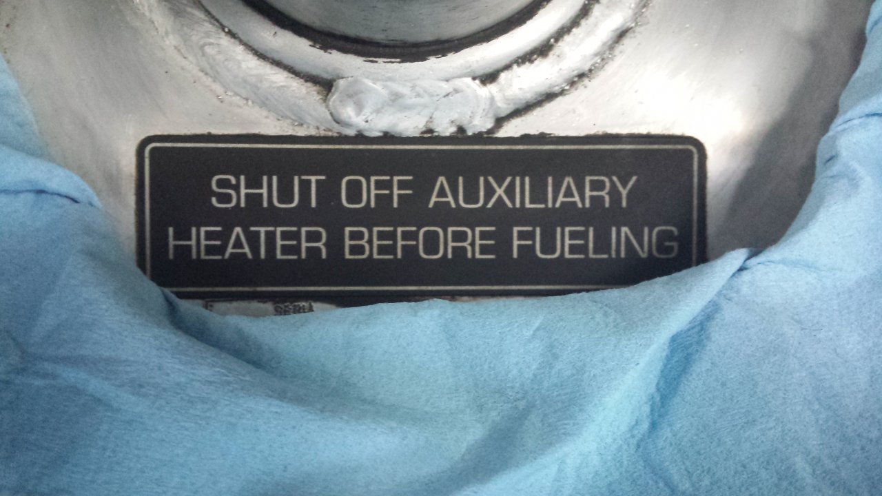

  8. dca
    dca Road Train Member
    6,834
    11,427
    May 31, 2011
    Earth
    every truck I've been in that has a bunk heater has a be sure it's off warning sticker before fueling near the fuel tanks. this suggests they do run while rolling.

  10. snowwy
    snowwy Road Train Member
    20,556
    13,285
    Jul 6, 2009
    Never seen that label.
