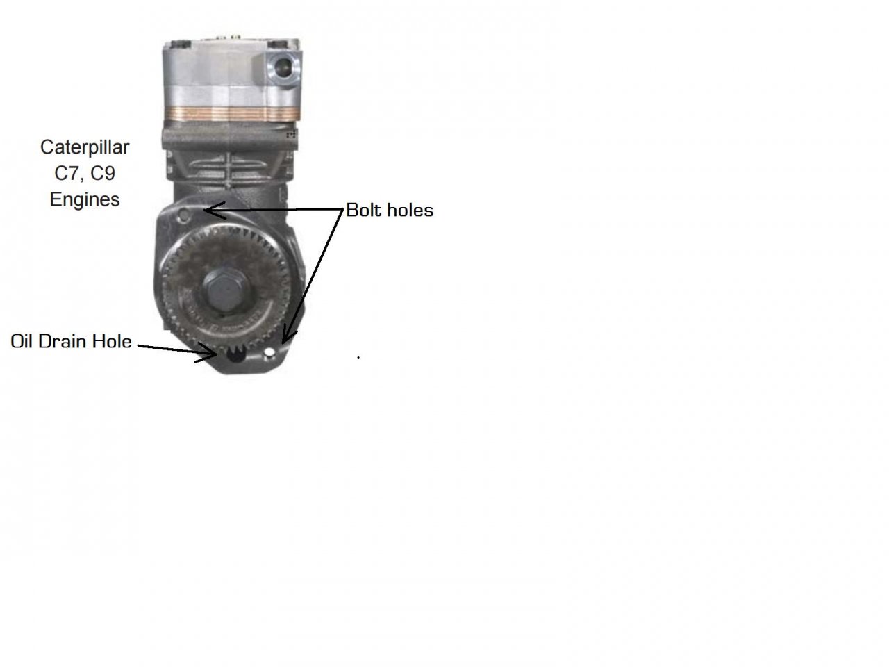

    The oil will drain out of the compressor by gravity to the engine crankcase through the gear train housing. Usually there is a hole at the bottom of flange. Should be a gasket for the main flange and an opening for the oil hole. Should look something like this;

  8. swaan

    I'm almost thinking he has the gasket 180 degrees around and blocking the drain .

    thats exactly what i was thinking when i removed the air compressor the second time. I am 98% positive i have it on the right way. I even marked the gasket to make sure it had the oil galley opening correct on this most recent install. I really do not think that is the problem and here is why. The very 1st compressor had excessive oil leak, so i replaced it with a reman compressor, that compressor then demonstrated the exact same problem, so i double checked to make sure the gasket was correct on the 3rd air compressor installed. Its just too coincidental all three compressors have the same problem, the first one to the last one. Wonder if there is some odd crankcase pressure going on... i even tested my blowby system and pvc vavle, everything is clear..i removed and cleaned out all tubes and filters. I am ready to #### give up on this truck...
