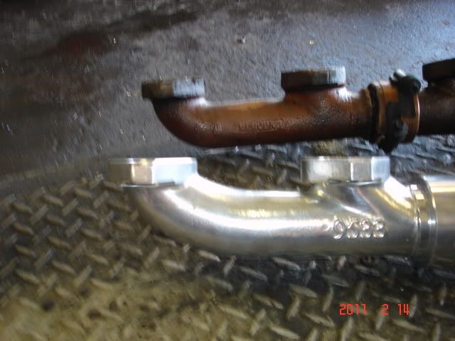

    I switched in February last year from the stock OEM on my 98 Cat 3406E to the Pittsburgh Power exhaust manifold and you can see the difference in these pictures side by side of mine.
    You can see the it is alot smoother and is suppose to flow 40% better than stock OEM manifold.
    I made this change along with PP's larger turbo (B/W) for a gain of 6/10ths mpg and it had alot more top end power with cooler turbo temps. Sorry I can't tell you the gain of just the manifold and the turbo does have alot less backpressure on the interstate that would produce better mpg's.

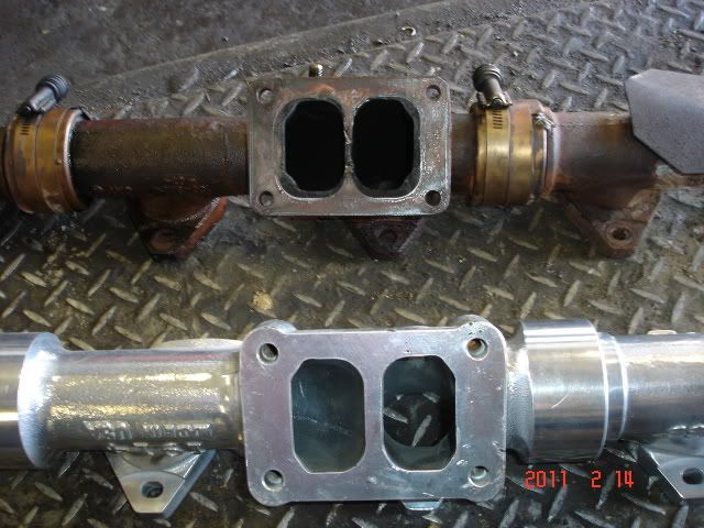

    Here is the turbos side by side.
    The new turbocharger has no wastegate also.
    The PP exhaust manifold and turbo allow me to run my PP Box in higher levels without it cutting back when the exhaust temps reach 1300 degrees. Considerably cooler exhaust temps at a higher level setting on the PP Box.
    Well worth the investment and would do it again.
