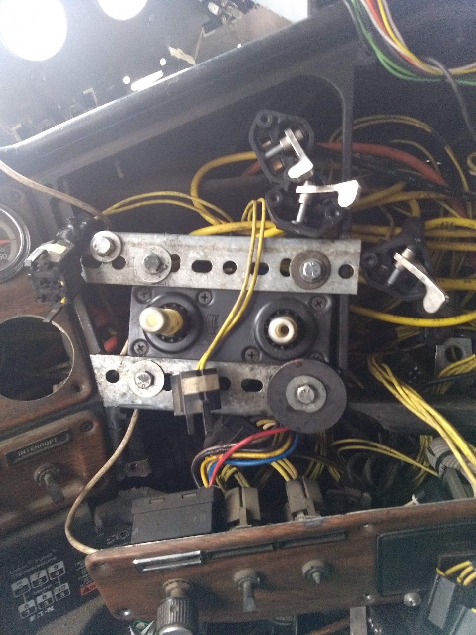

    This is what it looks like. I replaced the skeleton behind the dash valves.

    Good God what a mess. I see you reinforced the parking brake. Mines broken there also. Trying to avoid taking any more apart than I already have. I see new dash frames for sale on eBay. More work.I’d like to remount the parking brake. Bolting it on after the dash is in, making changing it a Breese. Freightliner has too many single point assembly bolts, that hold too many things. Doors are same way. Easy cheap assembly, I guess. Makes for a tough repair. A lot of it could be improved IMO. It all takes time.

    The metal pieces were to hold the old frame together. The new piece doesn't need it. Changing that and having the ability to install all the dash screws. Sure has gotten rid of a lot of rattles.
    Changed the MV-3 also. Fixed the venting and ran some new wire up to the headliner to provide direct power for GPS and dash camera.
