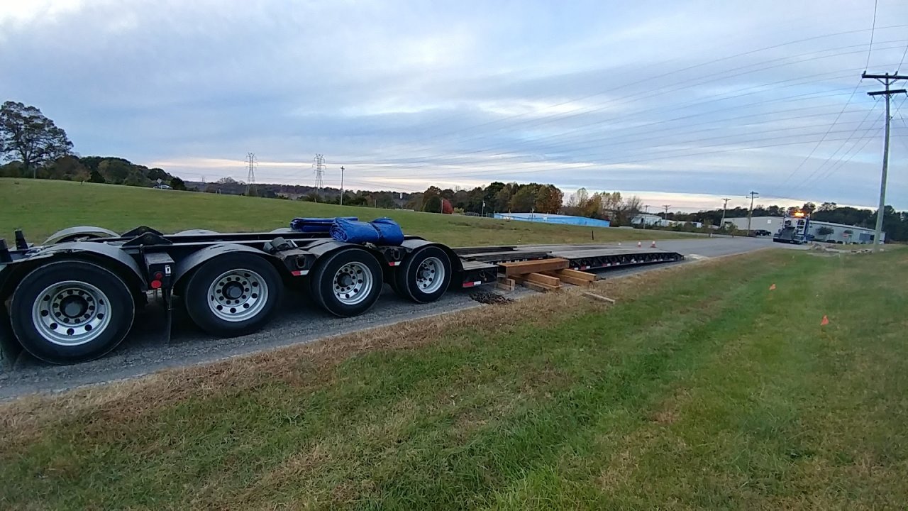

    In the last 4 years I've only had to do it once.
    stwik, kylefitzy, cke and 7 others Thank this.

    Looks good! Thank you! Some serious timbers!
    kylefitzy, Tug Toy, cke and 1 other person Thank this.

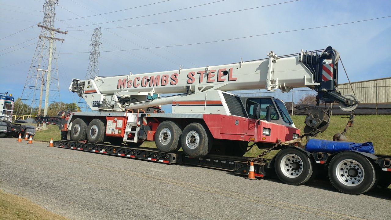

    maybe didnt need to on that one huh with that second truck crane steer axle still on the main deck?

    Chained the axle up so it wouldn't sag.
    TripleSix, cke and cgilliland Thank this.
