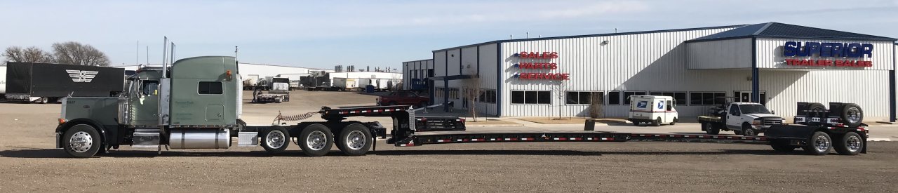

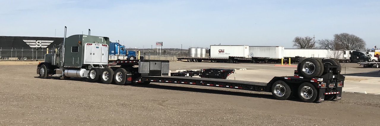

  8. soloflyr
    soloflyr Medium Load Member
    563
    1,688
    Nov 6, 2009
    Houston, Texas
    AF0A344A-8D5F-4717-8D34-BDC32E0ABF50.jpeg 5CB71A8C-F88A-4F75-B190-8355759AE0BA.jpeg 2018 XL 40 Ton Extendable, 29’ 7” closed, 49’ 7” open, 10’ full front deck, fully covered rear deck(s) other than the opening over the 2nd axle to accommodate for the flip axle hookups, 3rd axle flip, 36” flip neck.
    Comes in at 20k without the flip axle or flip neck, 23k with the flip axle without the flip neck, just shy of 25k with flip axle & flip neck.
    lynchy, Otr Traveler, Luwi67 and 9 others Thank this.
