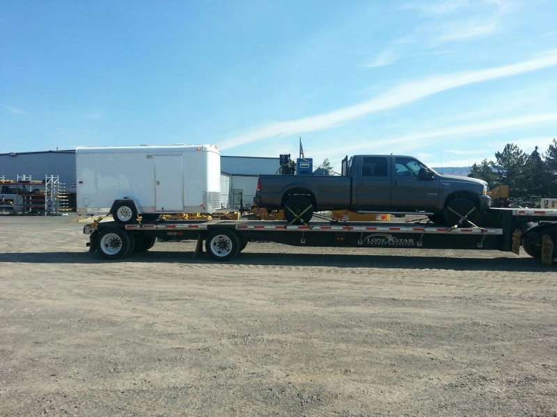

    uploadfromtaptalk1404320779018.jpg well, heres the final product... 16in of rear overhang

    Looks good. You might want to add a couple flags at the back of the trailer just in case an over zealous DOT officer looks twice. I pull a 53ft step. I have 43ft on my lower deck and 10ft on my upper. I have had vehicles with as much as 2ft of over hang on the back as well as other loads with similar overhang. Even though I know its not legal,. I put flags out and was never hassled. I doubt you would,.. but it is a holiday and from what I've been hearing, DOT is out in force.
    The van on the very end had almost 36 inches of over hang. Picked them up in Alabama and took them to Seattle Wa. No one hassled me even though they could have very easily. I think as long as you try to make an effort, DOT will generally leave you alone.
