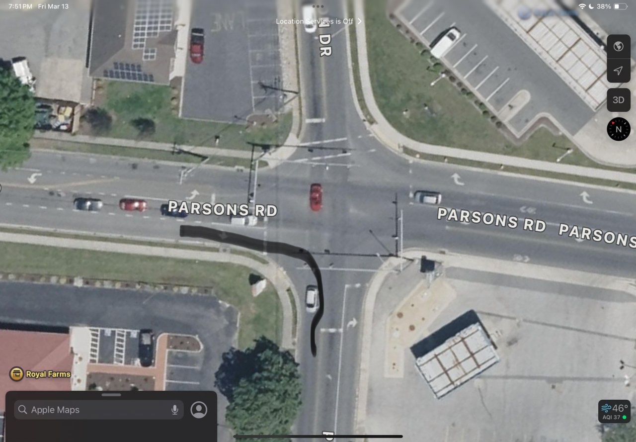

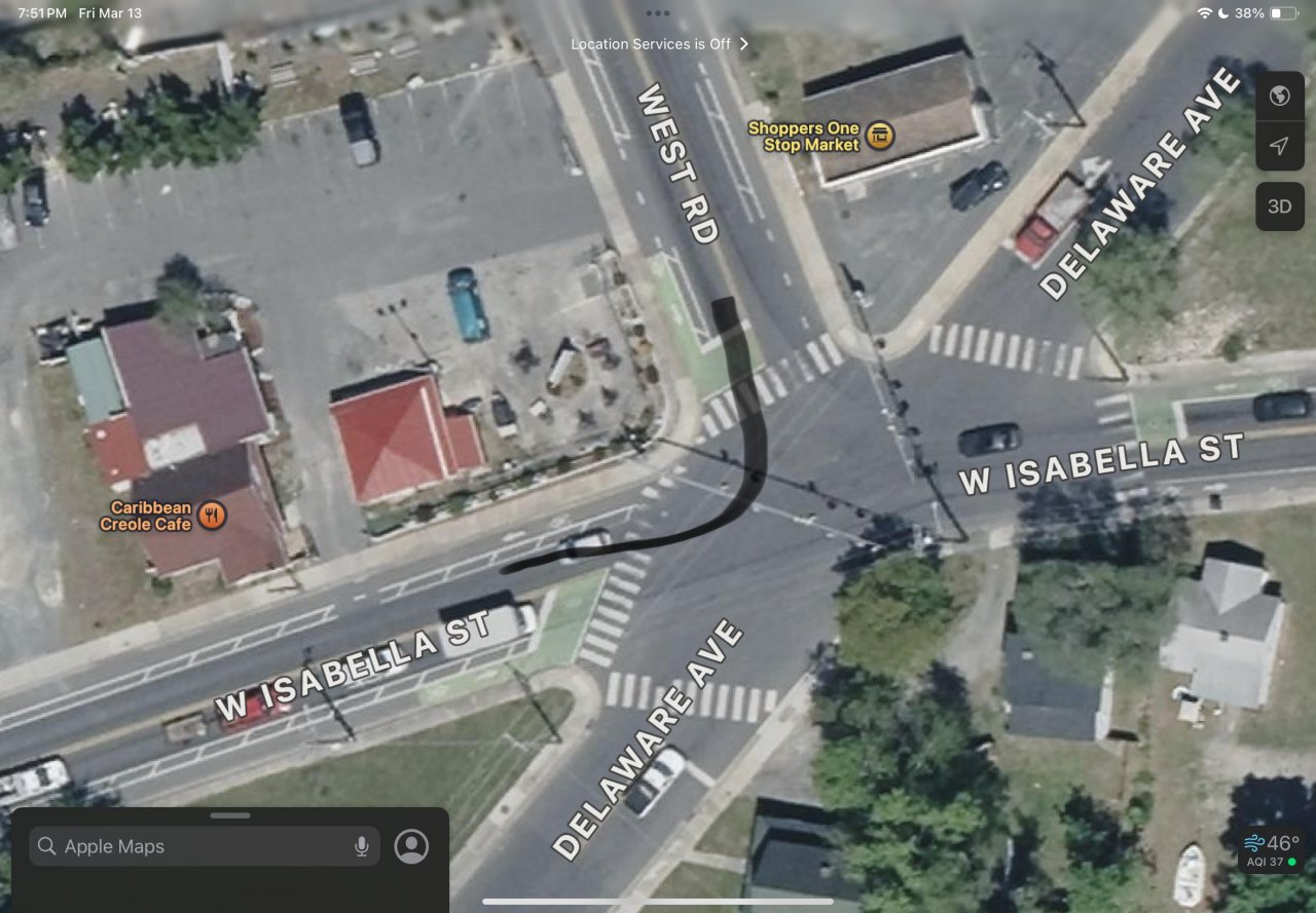

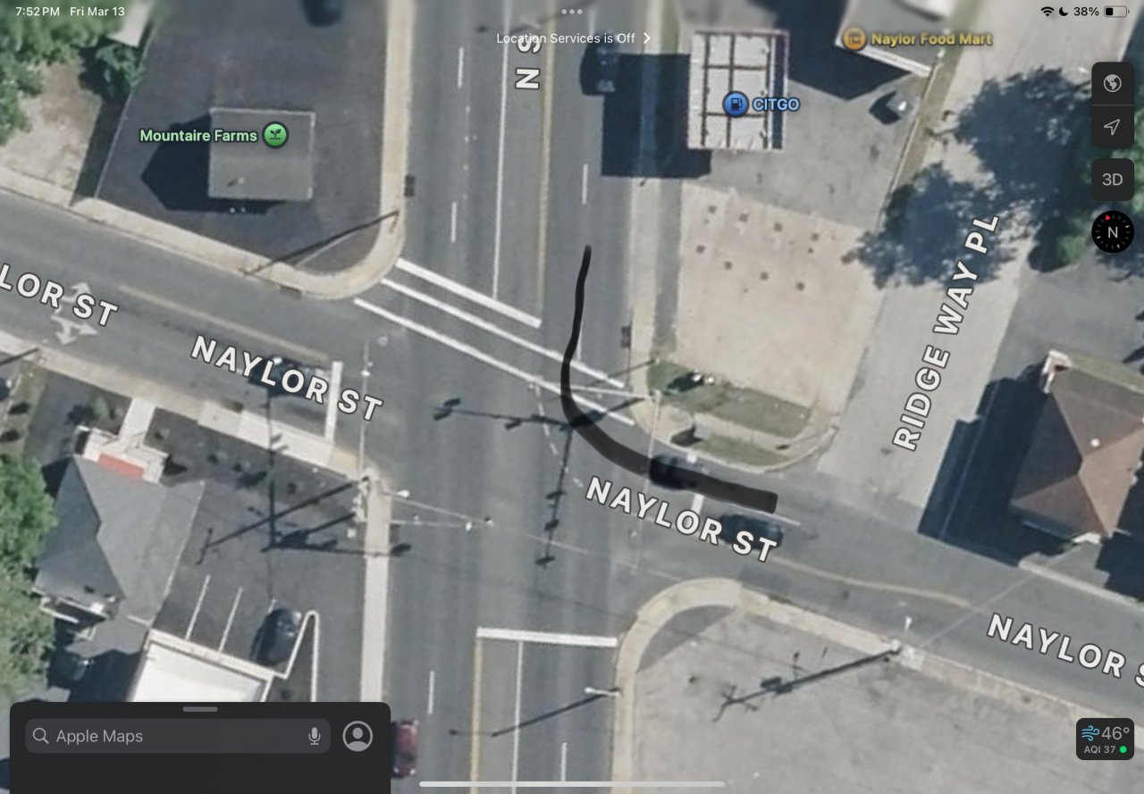

    Here’s a few I encounter in my usual travels.
    Easy…
    Tight, but doable with no oncoming traffic. You’ll catch the curb here if there’s a car at the stop line and you don’t split the lane beforehand.
    This one I won’t attempt except in the middle of the night, along with a left coming from the opposite direction. Fortunately I know another route to get to the businesses on that street.
    All of this is with a 48’ liftgate with the axles slid back because I hate tailswing.
