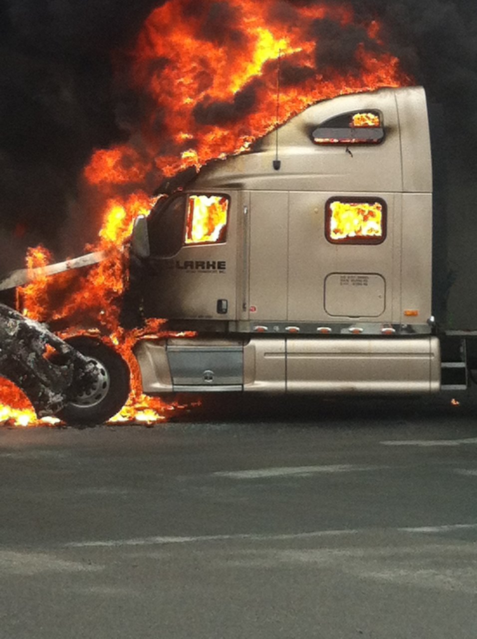

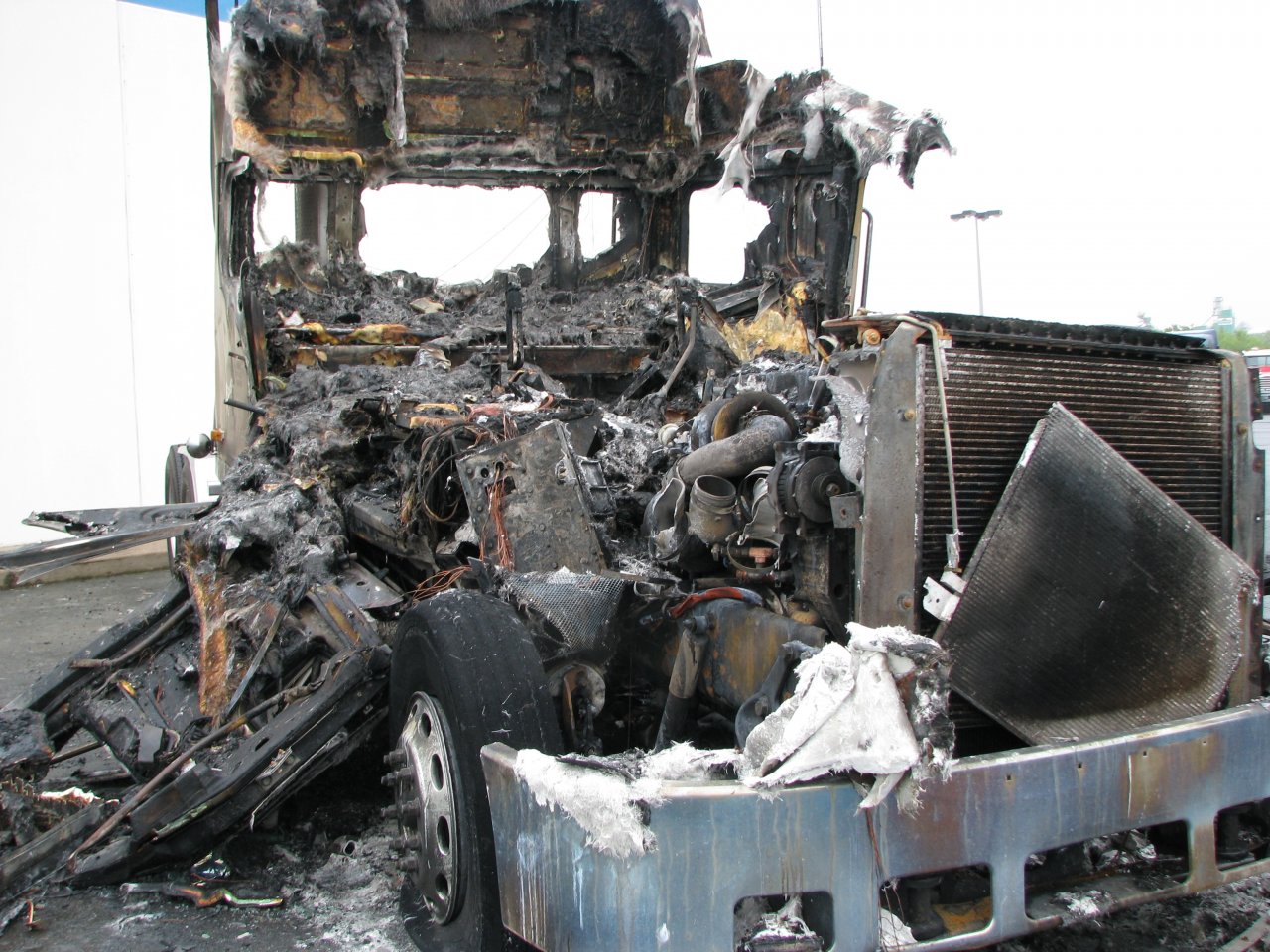

    Paccars bad wiring is NOTHING NEW...... ask me how I know.... IMG_0319.jpg IMG_0003.jpg

    its tru...im having electrical issues with my 2014 peterbilt paccar mx13...but nothing as extreme as your posted pictures.
    I mean that has to be 1 truck in 100,000 if that and probably a non-dealership backyard mechanic that worked on it, I'm guessing

    It had a c15 in it. The wiring from battery box forward to the starter and goes thru a hold down on the engine or close to it and the causation engineer said it chafes there, and cheaper wire/insulation wears thru, and they catch fire. He found more than one example of it and apparently several insurance company's are persuing them for this. This was 2012, truck was only
    5 years old. I lost my shirt. "Actual cash value" is what they pay out. Not retail.
    Edit, the engineer said Paccar products do burn up, more than other manufacturers, but all the newer trucks use cheaper off shore wire that doesnt age well and is susceptible to chafing.
    ALL of my trucks since, 2,.. have 2 smoke detectors. It went up FAST. I use the pics mostly to I form people, it happens quickly, thankfully I had just parked it and was home. 12 hr earlier I'd been sleeping in it.
