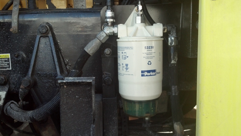

    On my last truck 8PN I had the fuel preporator airdog. I installed a compound gauge, vacuum/pressure, the gauge was installed between the airdog and the mechanical pump. With the switch on about 15 pounds pressure. With the switch off very little restriction like 2 inches vacuum. Ashcroft is who made the gauge. That being said this is what I put on my 6NZ. Racor 3150R with the 3238 10 micron filter 150GPH
