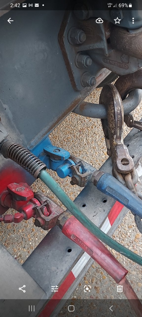

    I always set the trailer brakes and then reverse a little against it to take pressure off the rear trailer kingpin so it's easier to unhook because doubles have more slack and will keep pressure on the rear pin when trying to unhook.
    This pic is looking thru the back of a daycab, you can see the gladhands are on their blockoffs so as to not leak air . Always block them off when moving the dolly or moving the lead pup and a dolly. Screenshot_20240101-144123_Photos.jpg
    Some trailers will have these valves to open the air to the lines, some will have shut off valves underneath the lines within arms reach, and some will have dummy gladhands. These are in the open position.
    If you go to move the dolly and it won't budge, look for a button to exhaust the air or a pull cord for draining the tank. In this pic it's the button on the bottom of the frame rail underneath the number 5 on the dolly by the draped red air hose.
    Also, if the dolly won't move sometimes you need to supply air from the trailer if it has sat for a while. And always watch the air lines on the dolly, they are covered in grease
