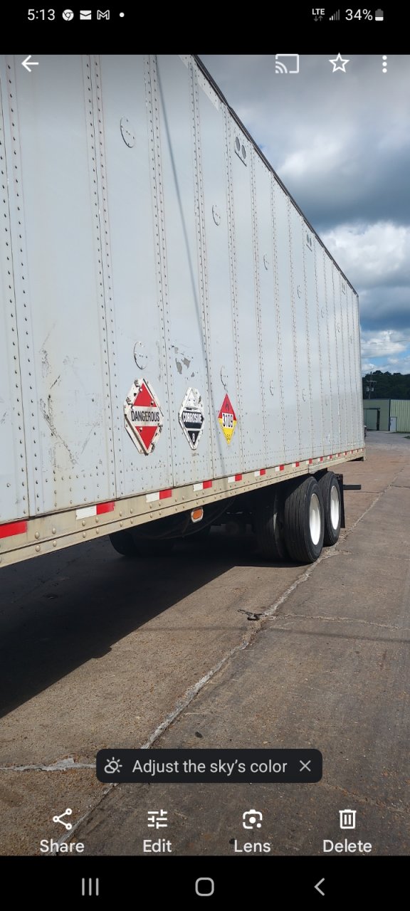

    I can assure you Fedex is by the book when it comes to placards. We receive the hazardous placard instructions with the manifests and are provided with all necessary placards to meet DOT requirements. We also have placard stickers for displaying bulk packaging. We have to make the stickers up placing the UN numbers on them.
    I've had times where I had three different placards on my trailer and I had to be aware of how the placards changed as I unloaded each hazmat shipment. Hazmat can be quite confusing and in depth especially with repsect to hazardous classes, bulk vs non bulk etc. We train on it every year.
    Here's an example of a bulk shipment plus a non bulk corrosive, plus two other table 2 that meet the dangerous requirement I had.

    Yeah, it's by the book, and it does make sense, just a different gestalt that takes some getting used to. My old safety department's policy was "more than 1,000 lbs total of hazmat placards are required for each class on the trailer, more than 8,000 lbs of any type gets a separate placard with the UN number on it", which makes sense in the TL world where there isn't a lot of hazmat class mixing. It makes no sense in the LTL world, and I'll make the adjustment, it's just weird.

    As I understand it, the 8800 lbs or so requirement means an ID placard is required for that particular product, IF that particular shipment is all the same UN number and it’s the only thing on the truck.
    I had a situation once where my last delivery that day was 9000 lbs of wet cell batteries, obviously corrosive for sulfuric acid, UN 2794. It was the only hazmat I had that day, so before I left I put the ID placards on then so I wouldn’t have to change them later. They weren’t yet required, but otherwise still legal.
