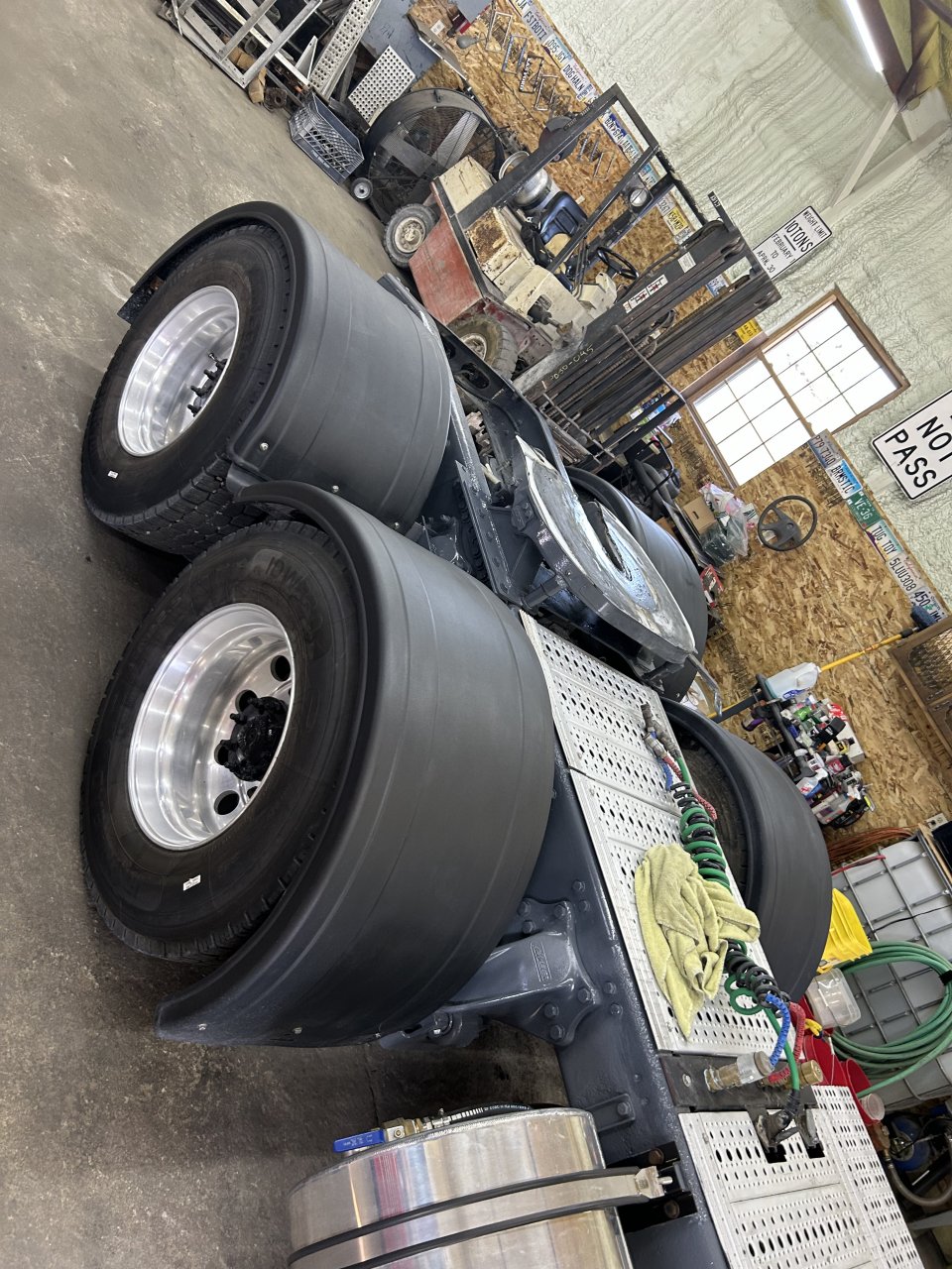

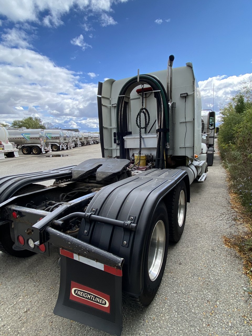

    I have the poly fenders on both a Freightliner Columbia and a Pete 389. I've had the set on the Freightliner for about 7 years and they've held up great. I bought them from a company in MI. I liked them so much, I bought a set for the 389 I bought 6 months ago. If you absolutely destroy them, you can just order a replacement one as long as you don't break the mounting brackets.

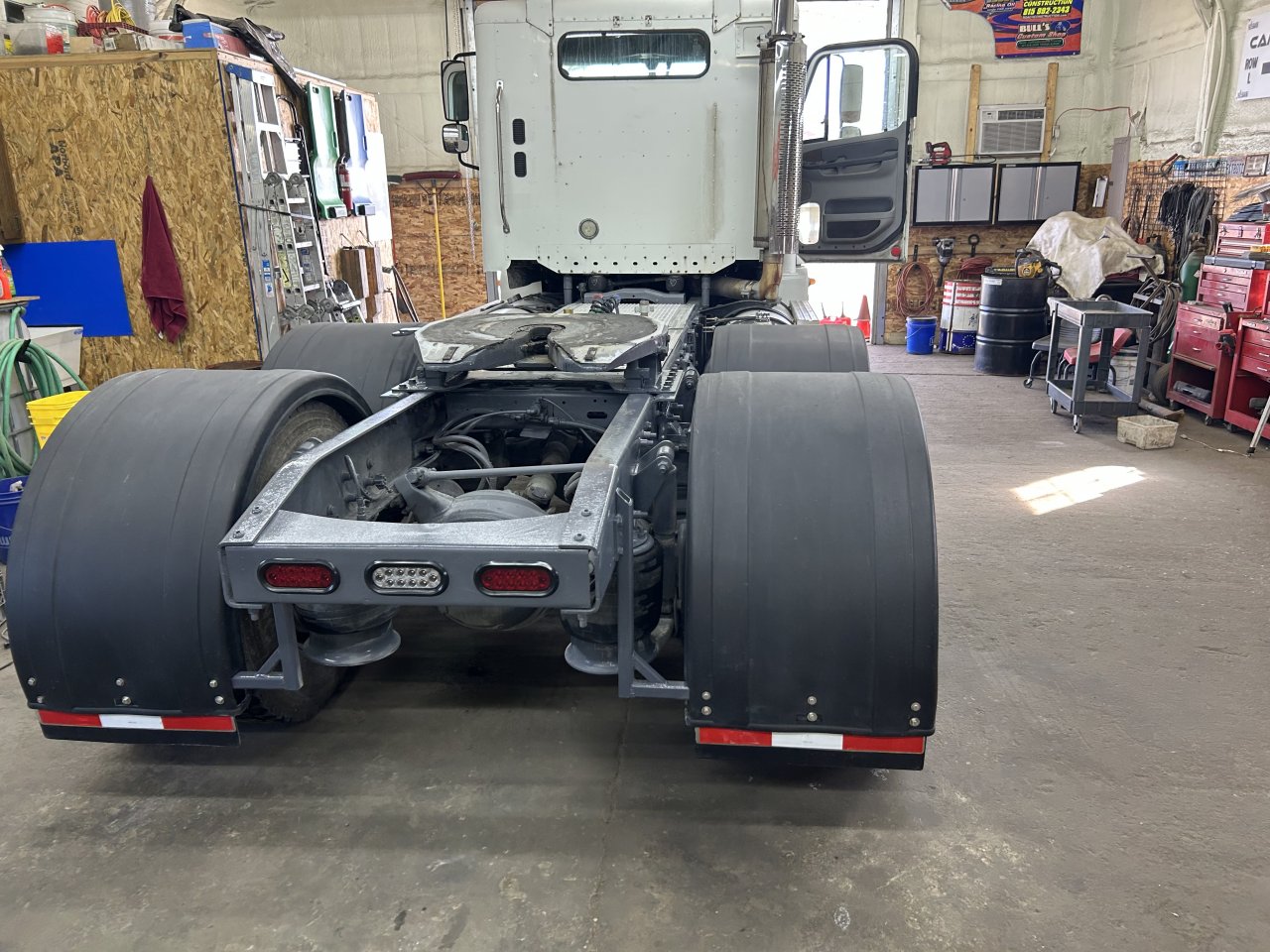

    These are $100 each from Vander Haggs. I made my own mounts. I try and keep the tires covers as much as possible to keep the truck as clean as I can. Oh and the back glass and mirrors intact… IMG_4529.jpeg IMG_4554.jpeg IMG_4553.jpeg
