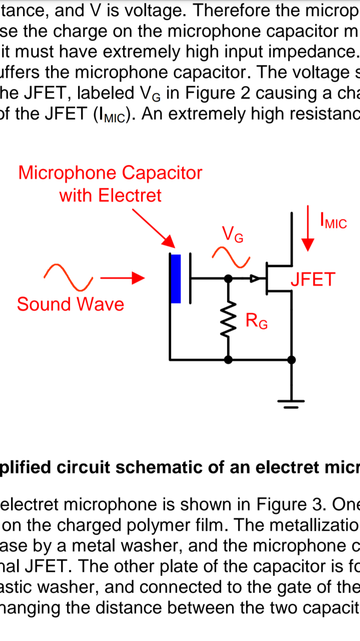

    Well it is an electret mic, unless you opened it up and changed the amp in it.
  10. rabbiporkchop
    9,678
    6,548
    Feb 9, 2012
    Wapwallopen, Pa
    An electret mic contains a small JFET to amplify the signal coming from the microphone diaphragm; the specific JFET is selected by the manufacturer to ensure the microphone has the right gain and response. Usually these JFETs are chosen with the expectation of a relatively quiet environment, and trying to record a concert only results in a ton of distortion. By putting a resistor between the source of the JFET and ground of the microphone, it’s possible to reduce this distortion.
  11. rabbiporkchop
    9,678
    6,548
    Feb 9, 2012
    Wapwallopen, Pa
    looks like I see one in this picture.
