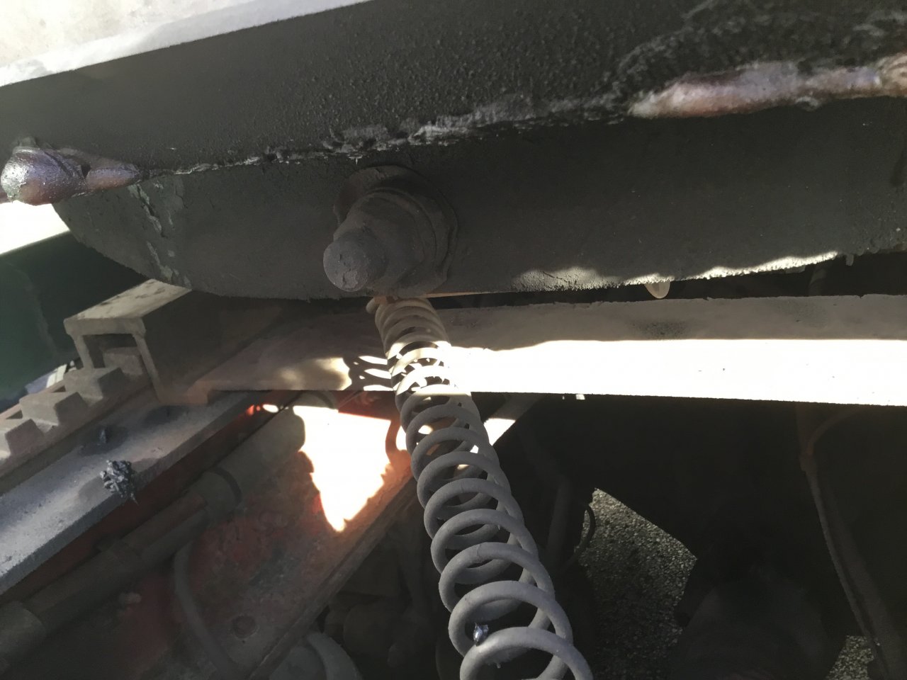

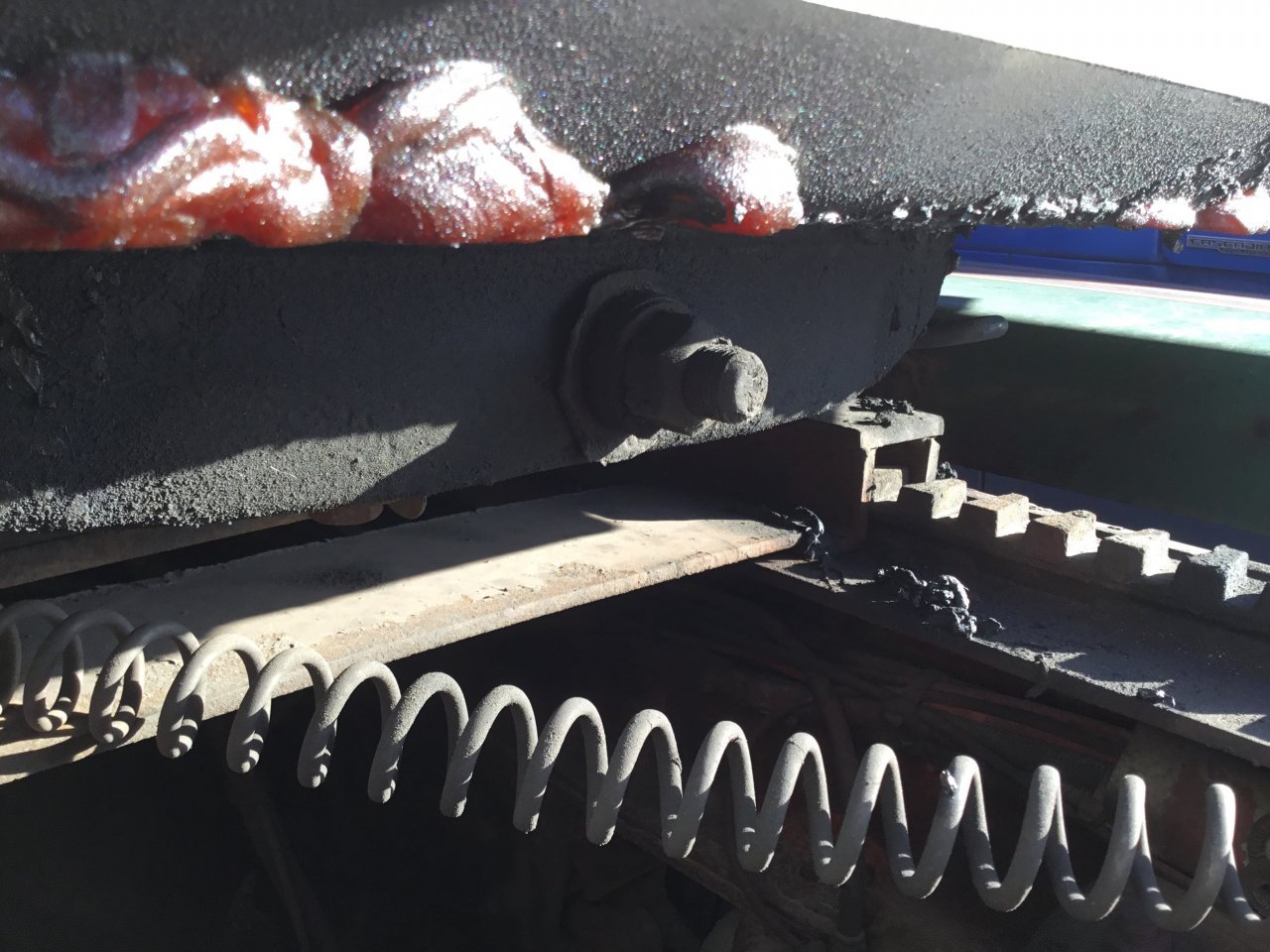

    Hi y’all. I have followed this form for awhile picking up the do’s and do nots of this industry. Obviously this is my first post. I have some slop in my fifth wheel. I am on my 34 right now and would like to know the proper way to adjust the fifth wheel. I have a 2013 Pete 389. The wagon is a 2019 so I have a hard believing it’s in the kingpin. Help would be much appreciated and I have pictures of the bolt that I believe is used for the adjustment.

    You don’t have very much adjustment left. Turn the nut counterclockwise to take up the slack. Inch and eighth socket. Best done with a tool but can be faked turn adjust nut rehook check release repeat as needed

    Okay, thank you. I guess since there isn’t much adjustment left, I will be looking for a new fifth wheel plate here shortly

    I’m in the same situation. As stated, while eased up on trailer, loosen bolt,snug it up, not too tight. Need to be able to turn washer be hand. Not textbook, but it works. Don’t forget new bushings
