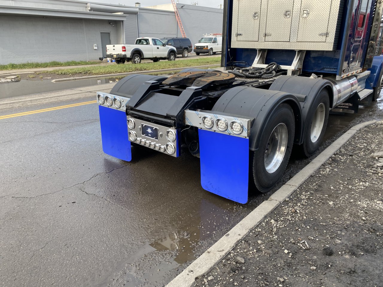

    5150D5AF-D6C9-4F02-95CD-68D7AAC8BF96.jpeg 3915B946-39E7-4AF7-9418-CE010467E8AD.jpeg

    No I backed up too a trailer that had a lower landing gear just to test it out and everything went smooth. Trailer didn’t touch the fenders and that ramp helps allot from hitting anything

    I got it dropped to 47.5 :) so we are good to call the vans

    Changed the fifth wheel and tires did the job

    If the trailer just barely clears the fenders on level ground there’s a good chance of hooking under your trailer while turning on uneven ground. I may be speaking from experience from trashing a set of week old fenders that looked good when I backed under my trailer. Lol. Similar situation to yours, I didn’t want to raise my 5th wheel because my cattle trailer sat level the way mine was. So I went back to stainless quarter fenders.
