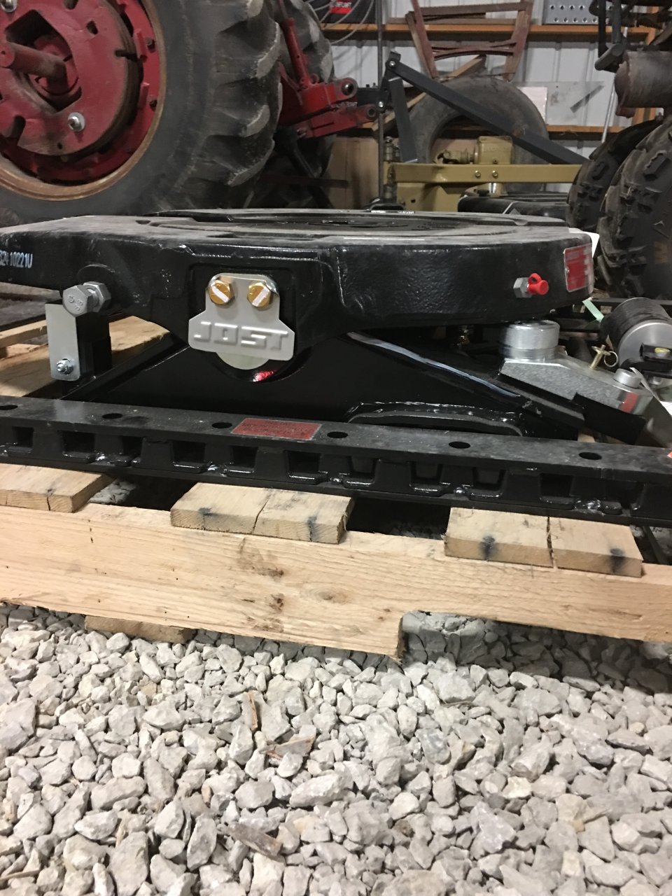

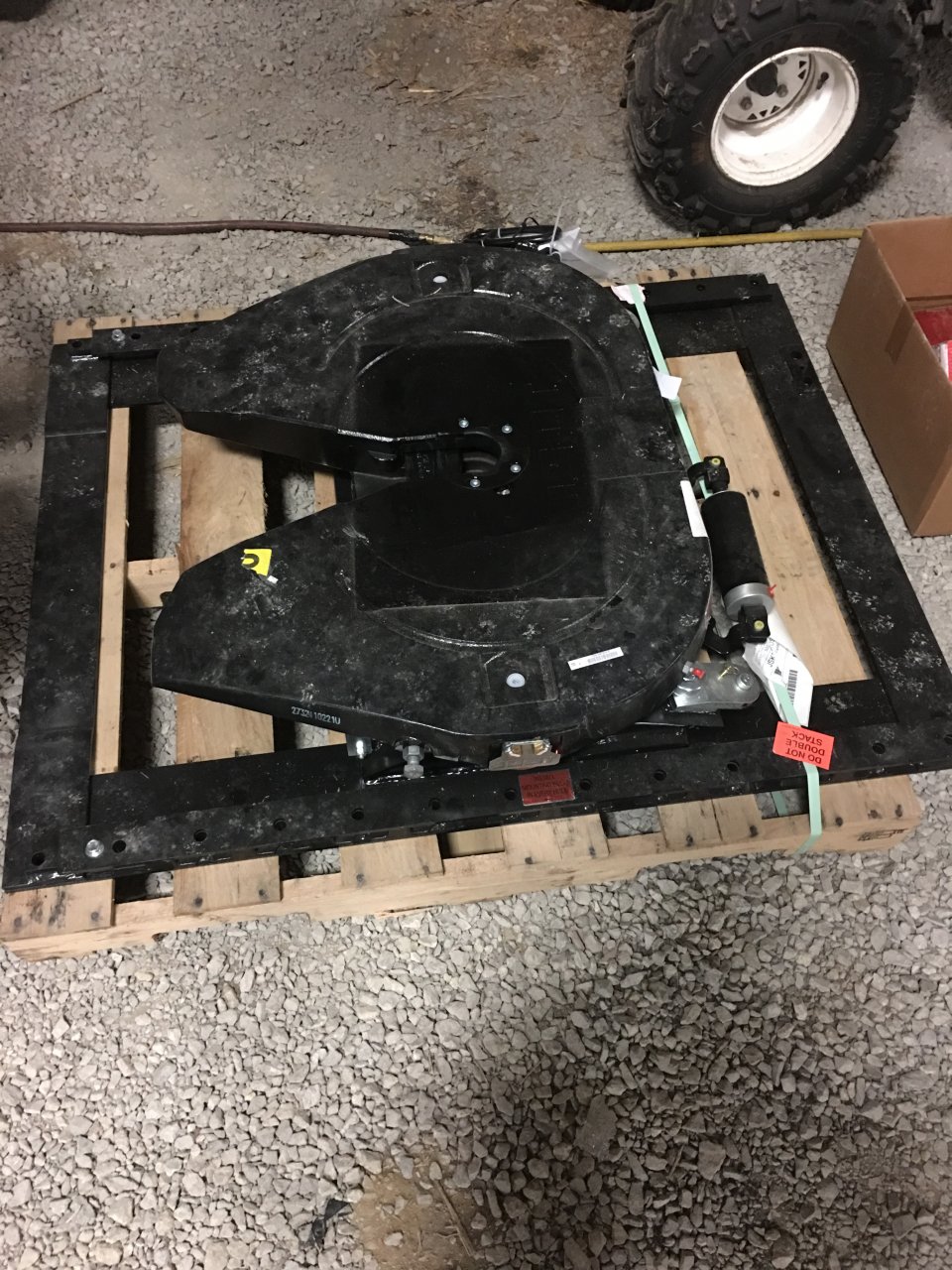

    https://www.jostinternational.com/wp-content/uploads/2016/06/5th-Wheel-Catalog.pdf
    Here are the different options for Jost.
    I think mine is a
    JSK 37USB-A7PX24
    Call Jost and verify specs for your application
    I went from inboard mount to outboard mount to keep height lower for no tilt option cause I sometimes pull a van or reefer. Keep that in mind when ordering. But seriously call Jost direct, easy to get ahold of. Give them part number and they can break it down as to the specs of that particular part number.

    Pretty much exactly what I'm looking for. Everyone wants my fontaine part number to cross reference but I don't want the specs it had from the factory. Apparently it's to complicated to tell them the sizes I want and look it up that way
