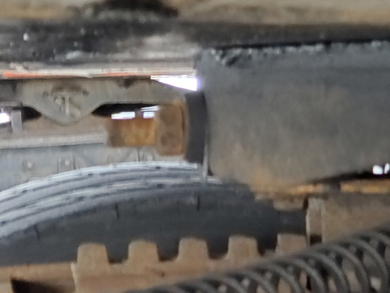

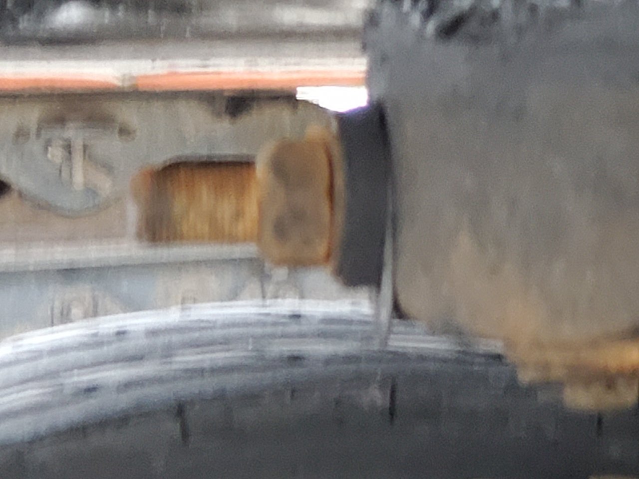

  4. Goodysnap
    Goodysnap Road Train Member
    3,774
    9,201
    Jul 12, 2017
    Yes clockwise.
    See if the rubber washer is tight when latched. Condition?

    I have been on the road for a couple of days but I had no problem unhooking at one of the places I deliver to. I did not touch the adjustment. We'll have to see how it is when I get back to the yard.
    Maybe it was a fluke?
    I don't know but I just wonder if I should get another fifth wheel. This month they are on sale at FleetPride genuine Holland fw35 for $995. I think that's pretty good.

    I had one a few years ago that was not latching
    Finally got it to hook and then had a shop mechanic where I was loading take a look
    It was some grease and crud build up under the plate that wasn’t visible
    He took off the plate and cleaned everything
    Worked perfect after that

    Yeah, the "mystery bolt", never knew what that did. I wouldn't say it's a fluke, nothing in trucking is a fluke, and if you go with another one, hit the boneyards. With all the wrecks, should be no problem. I see they go for like $2-$300 bucks. I knew guys that had theirs rebuilt, but that's risky. Like GYPSY sez, it's probably grease and crud.
