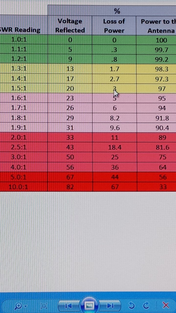

  5. Night Stalker10
    Night Stalker10 Road Train Member
    1,699
    1,271
    Jun 26, 2017
    Ok. You may want to talk to the firestick company then. They claim the opposite. The thing you have to remember about a cophased antenna system on a big truck, is that the RF lobes to the front and the rear of the truck, are larger than one's off to the side of the truck.
    CHOOSING SINGLE OR CO-PHASE ANTENNA SYSTEM

  8. Night Stalker10
    1,699
    1,271
    Jun 26, 2017
    Assumption or not I have no idea. I've always just heard over the years this is a type of pattern that these antennas have. Even in a book that Lou Franklin has, he shows a similar pattern with cophase antennas where the RF field is greater to the front, and behind the vehicle.
    Now granted in the picture he's showing, this pattern is with the antennas mounted in the middle of the vehicle.
  9. Night Stalker10
    1,699
    1,271
    Jun 26, 2017
    Sorry, the picture up above needs to be rotated, and I'm still trying to get used to this new phone. But I think at least gives everyone the general idea.
