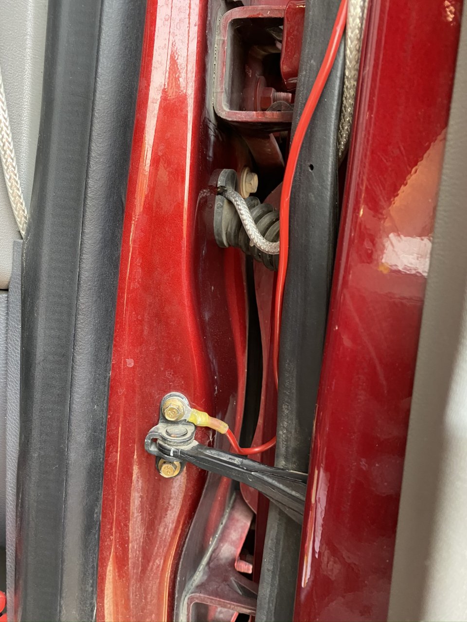

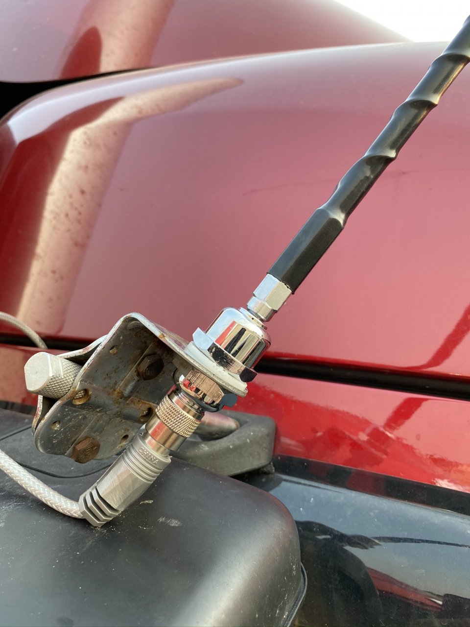

    Alrighty Folks,
    I bought a Stryker 447HPC2 w/ a Firestick Antenna (4') (Not Firestick 2). The location of the mount is on the side mirror of the passenger window. (Pictured) The mount location is 8'6" tall + 3-4 Ft Antenna. Antenna tip is right around 11' from level ground.
    I have a dedicated ground wire going from one of the antenna mount screws to inside of door. (Just for peace of mind). UPDATE: This also reduced the SWR by 0.3 or so.
    The wiring for the radio is straight to the batteries.
    I'm getting 3.4 SWR reading on the radio on Ch 40 / 3.1 on Ch 1 (With door open) / Door closed I get 3.1 SWR on Ch 40 / 2.8 on Ch 1.
    I'm thinking I need a longer antenna.. However, I do not know.
    1) Is it worth purchasing a longer antenna vs taking it to a shop?
    2) Am I thinking wrong?

    The gnd wire is acting as part of ant length..You need short braided straps..
    Connect those braided straps to either side of door hinges....Ant stud is junk..Likely the coax got pinched at one point..

    When I added the ground wire it knocked the SWR down 0.3-0.5. Would I use the braided straps in addition to? Screw one side in with the ground wire and the other side of the braided strap to the door hinge? Or how do you mean?

    Looking at other posts. I assume that you mean by the way it’s pictured here
    Would I remove my ground wire?

    Remove the one you have..look at its tune with out then add the two braided straps lime in the pic you losted and see...
    When you have long strands like you had it adds imaginary length to the antenna throwing off tune..
    Keep the braided straps as wide and short as possible..

    Find a shop to put you ant on an analyzer....Might shock you..
