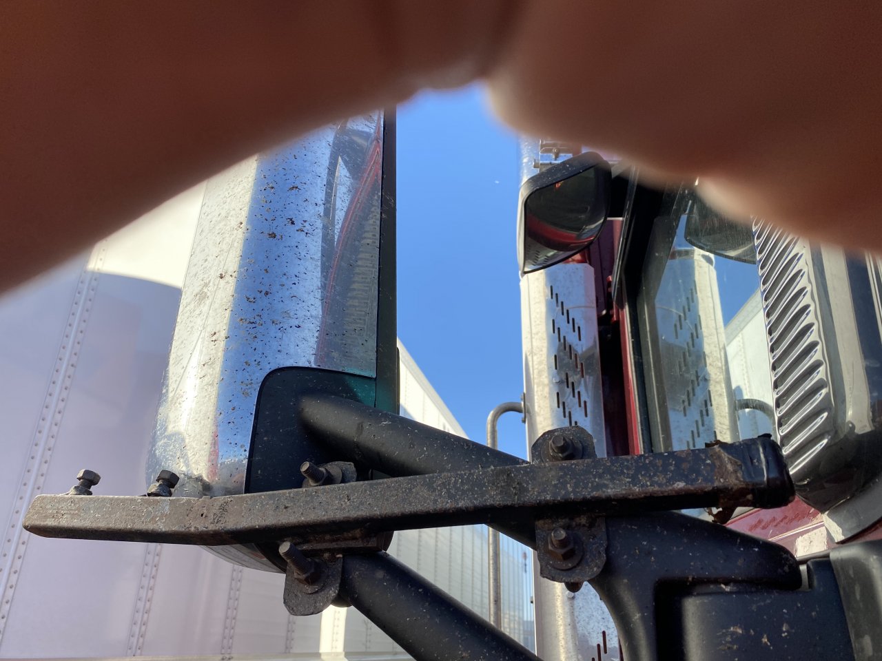

    Would it be okay to attach the antenna onto this flag holder? It’s not touching the truck at all and secured to the plastic mirror arm.

    Those are the best places to avoid.
    Free coffee and donuts isn't a good reason to do business with someone. Usually it's a good reason to avoid them.
    Not without an RF ground.
