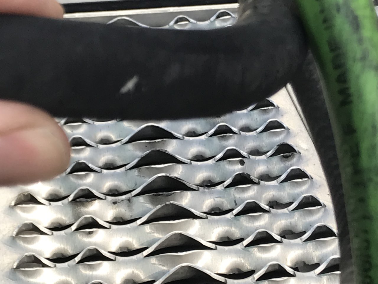

    Put this on your airlines and not get another chafed violation. 15_Ft_Nylon_Spiral_AirPower_Line_Wrap_20011__94303.1450892756.1280.1280.jpg

    I dont even think my hoses have that. Its a new trailer.
