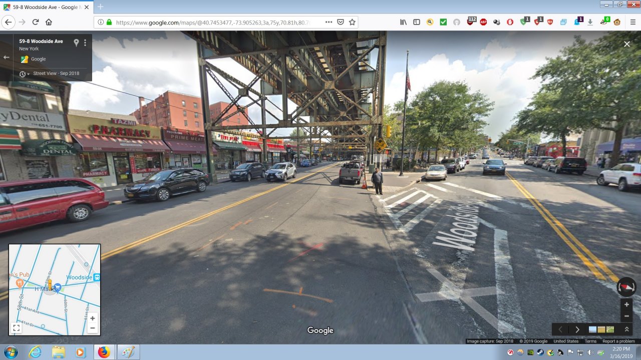

    I followed Roosevelt eastbound one more block and at Woodside Ave in the region between 59th crossstreet and 60th cross street you have a 12 foot 4 inch yellow and black sign posted just past the woodside corner above the man standing against post on sidewalk to right in this view.
    At this point I decided due to my rule of three. Once is happenstance. Whatever, Twice is coincidence. And there will not be a third time due to enemy action.
    I consider roosevelt not a valid route With these persistant yellow and black signs proclaiming 12 foot four inches.
    I have not forgotten the famously stupid way that NY State and NYC INSIST on being a foot short of actual clearance. I do not know where that habit comes from, maybe they get tired of being that high and don't wanna make accurate signs or something like everyone else does.
    If I were you, you look again for another route to your assigned end point of the trip.

    I’ve went under that. It’s possible but you have to bring your airbags down and crawl so the bumps don’t have you touch the underlings. Also stick to the middle of the road. I haven’t capped mine but the truck in front of me did. In other words AVOID AVOID AVOID.

    I heard they were in the process of changing the bridge signs to actual height instead of a foot short when this will happen and how long it will be some short or some right . the original thought on mar king them short was to allow for a foot of snow on the road ..... most of the streets that run under the l trains have low clearance the tracks are plenty high enough but the cross members arent.

    Some are marked 13’4 and they truly are 13’4. Some are 12’8 but fit 13’8. Some are even marked 11’9 but are really 13’5.5
