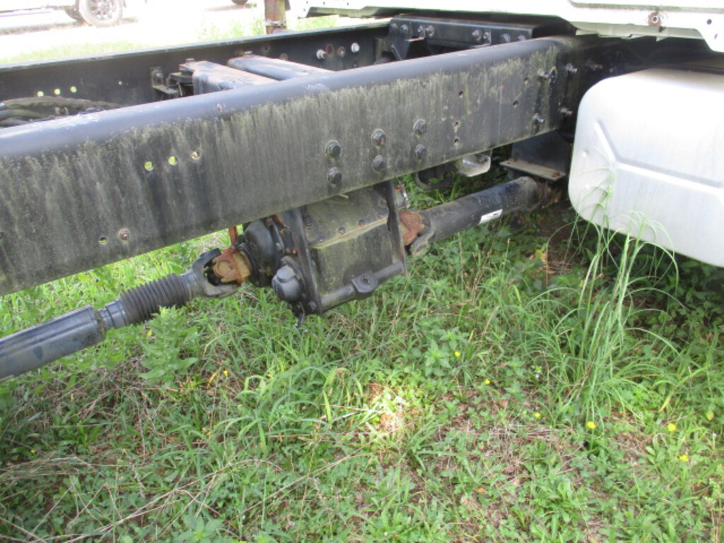

  10. Ridgeline
    Ridgeline Road Train Member
    22,720
    123,315
    Michigan
    Don’t do an isb, at least an ISC or ISL, see what it had in it for a trans, the dealer can give you exact model and serial numbers of the trans. Getting a trans for it may be an issue, seeing it has a transfer case attached to it unless you are going to use an unattached one.
    4wheelspin Thanks this.
  11. 4wheelspin
    4wheelspin Bobtail Member
    26
    20
    Sep 13, 2023
    South Carolina
    Yes sir the transfer case looks like it’s a discrete component. IMG_1616.jpeg
