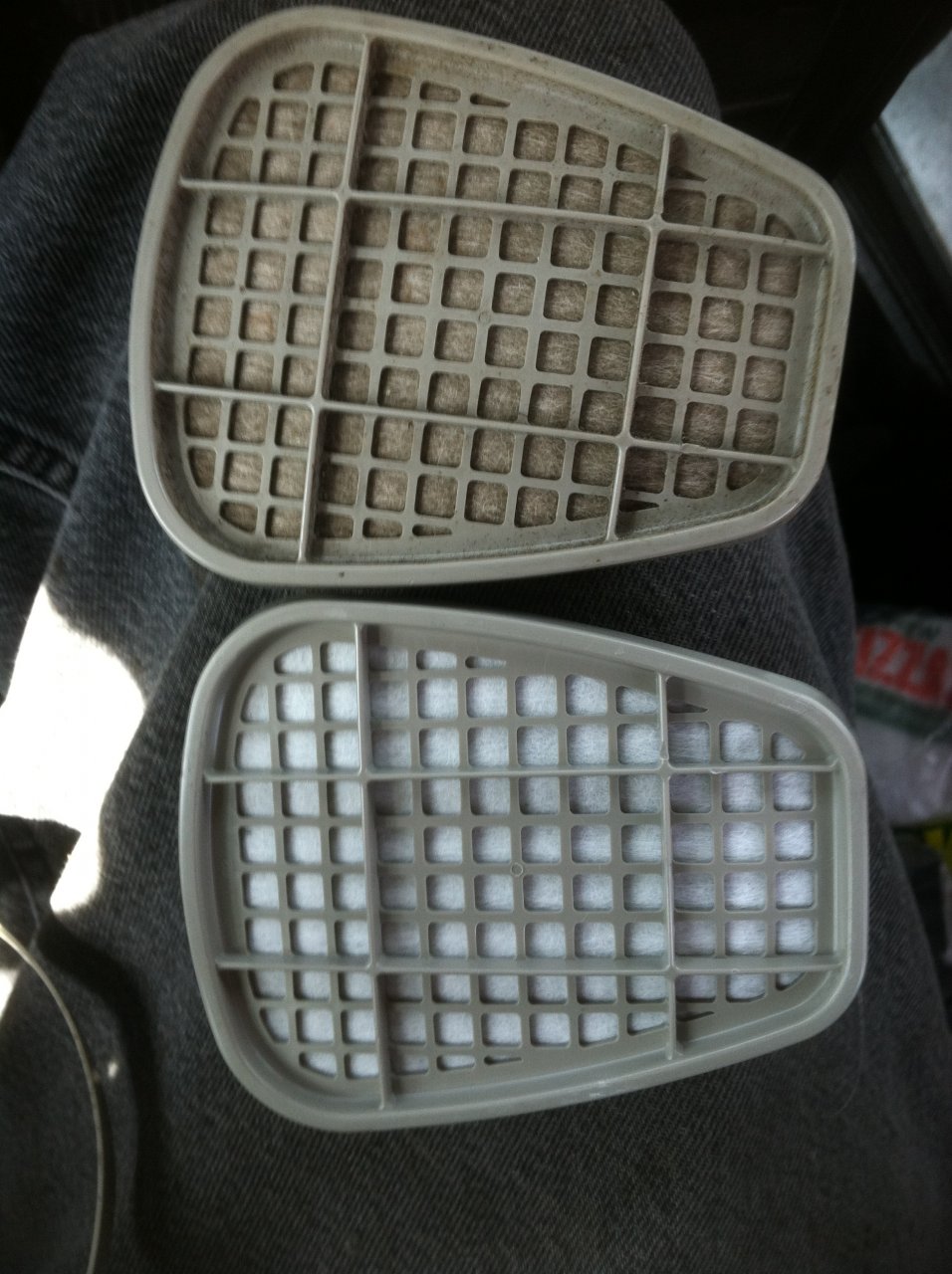

    Probably should do a little reading about H 2S. ......... it's in asphalt just a matter of how much.
    Some places make you wear a meter.. Most do not... But stand upwind and l wear a respirator while loading only.....
    Guess witch filter has 50 loads on it.... The heavy solids thrown into the air while loading 300F liquid can't be good for you.......also this set up is good for H 2S up to 1000ppm (I think). But I wouldn't trust it.....
    Liquid Asphalt is a good gig, however when things go bad they go bad in a hurry. Pay attention!
