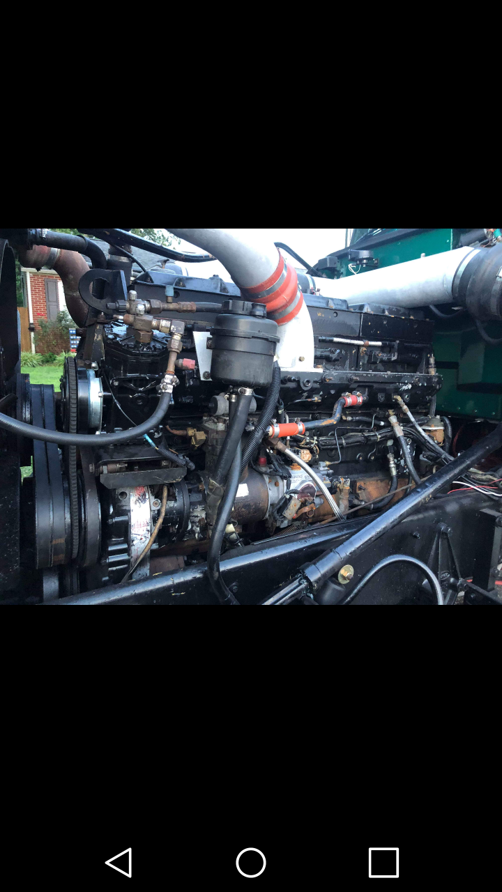

    Looks like a mechanical N14. Do you have a engine picture from the drivers side? Great engine , easy to work on and cheap to overhaul with a trustworthy and knowledgable mechanic.
    IMHO owning any truck new or old is a money pit. If you are mechanically inclined and not afraid to take on most repairs then the odds are in your favor.

    No ECU in sight good engine you got there. As others have stated have the fluids sampled and dyno done before purchase.

    Well if that truck is in 1988 that's not the correct engine. Not that it's a bad thing at all the mechanical n14 is awesome. As far as I know the mechanical n14 was the early 90s.
