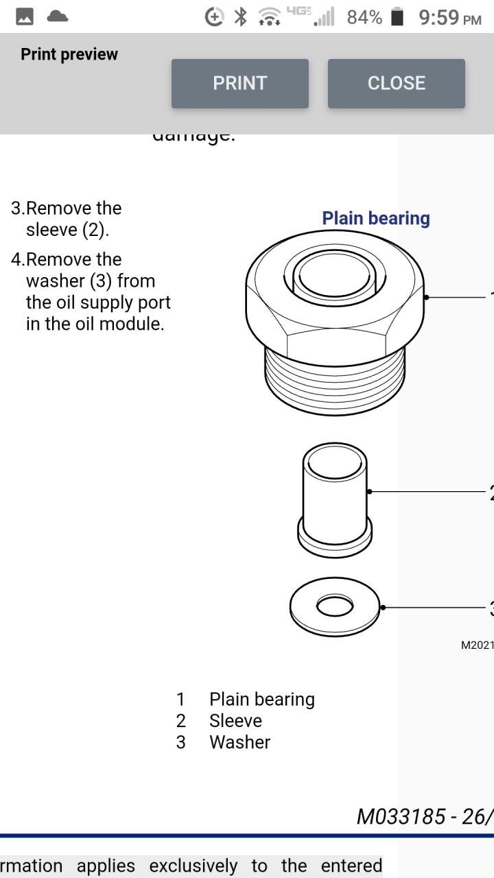

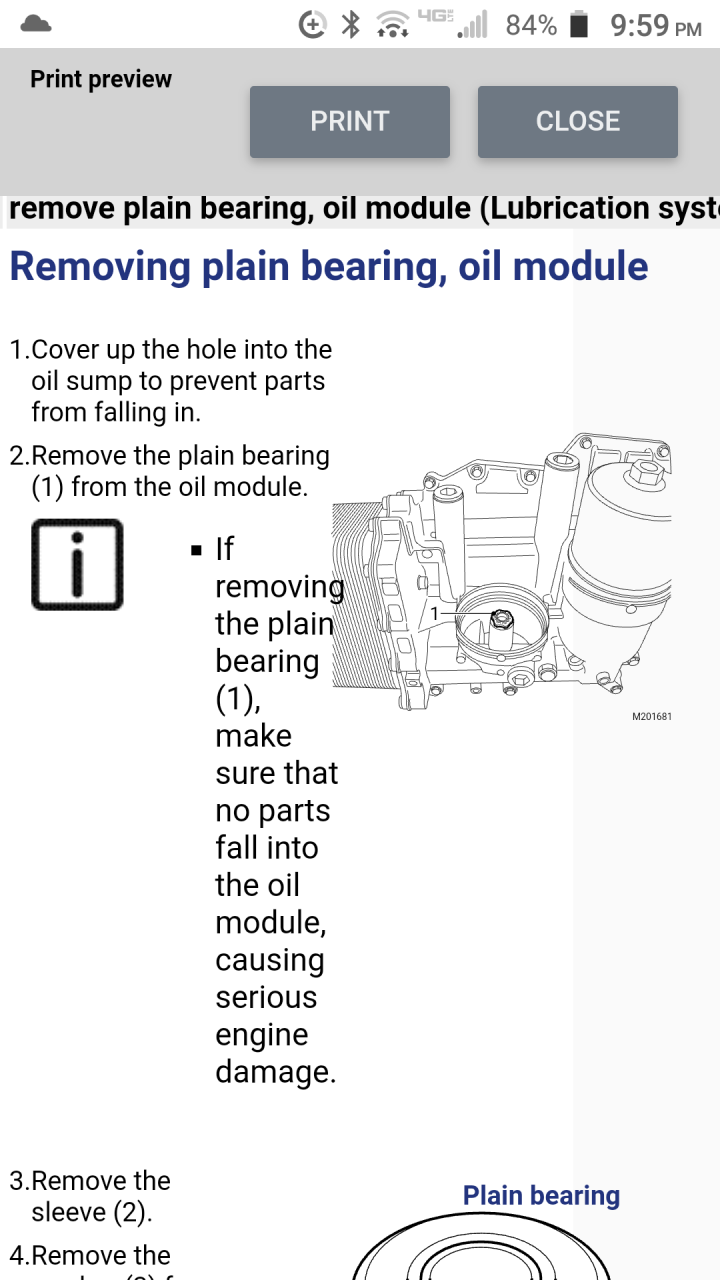

    Can't attach pics in PM, so this is bearing I am talking about, item #13. Screenshot_20210715-215921.png Screenshot_20210715-220004.png Screenshot_20210715-215935.png
    Accidental Trucker and 94coupe Thank this.

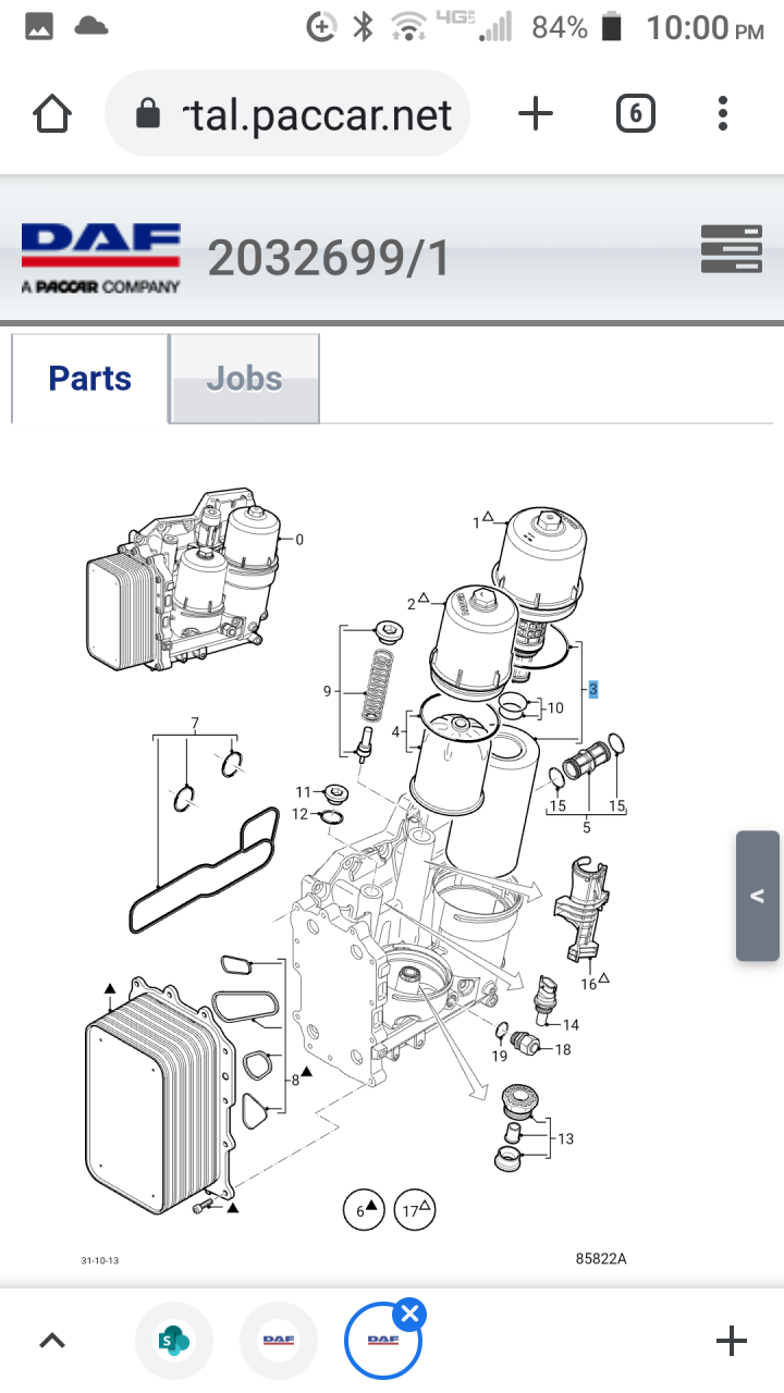

    Oil temp sensor on MX is item 14 in picture, tied into oil module. Interesting one on Cats with ACERT didn't have sensor, just calculated value for ECM.
