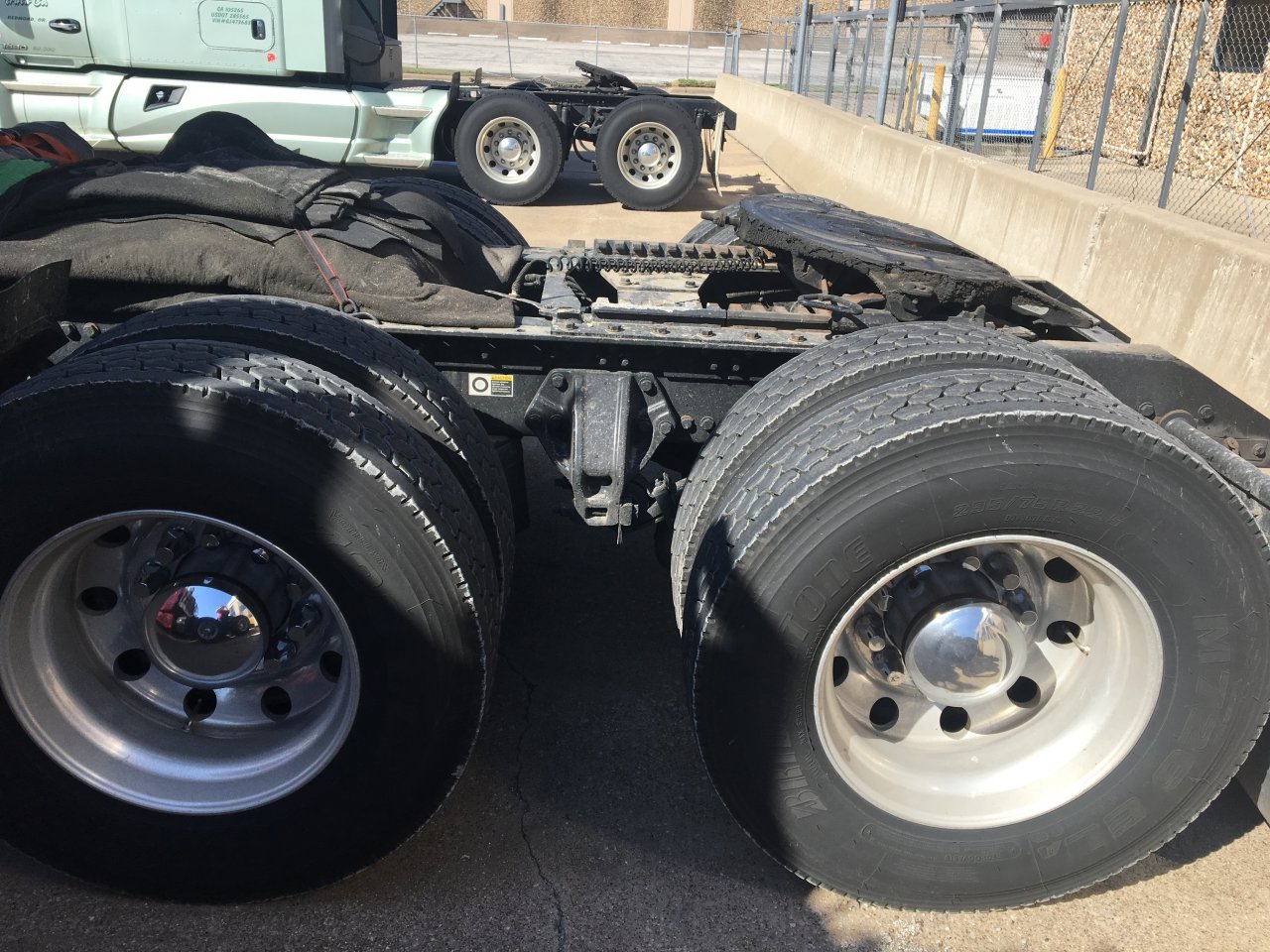

Fitting a headache rack behind a 379

    If that’s a 63 inch sleeper you don’t got 260 inch wheel base
    spyder7723, Oxbow and Ruthless Thank this.
  3. T-800
    T-800 Light Load Member
    98
    45
    Sep 20, 2014
    Frankfort, IN
    Just measured my truck. 250” base, and 5’ clearance with a 18” pin setting. I don’t know what most van trailers are but I remember the company I occasionally pull for has trailers with a pretty far back pin

    I think most vans are 36 inch pin

    How did you measure your wheelbase?

    Center of front axle to right in between the tandems

    Cheapest option is going to be to address the issue with your 5th wheel. If it were me I’d just get a new one that’s mounted on a 36” slider and that would give you plenty of room.

    Just move your fifth wheel slider back. Cheap and easy. I haven’t moved my fifth wheel in months but I also have a set back front axle.

    Slide your fifth wheel slider back you'll have plenty of room for a rack

    I drive a 244" short hood 379 with 63" flat top and have a mile of room between trailer and rack.
    And my fifth wheel is a few notches away from the front. You should easily be able to pull most deck trailers, especially steps. Just don't try to do B-trains, lol.
